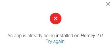

App store reports "An app is already being installed on Homey. Try again"

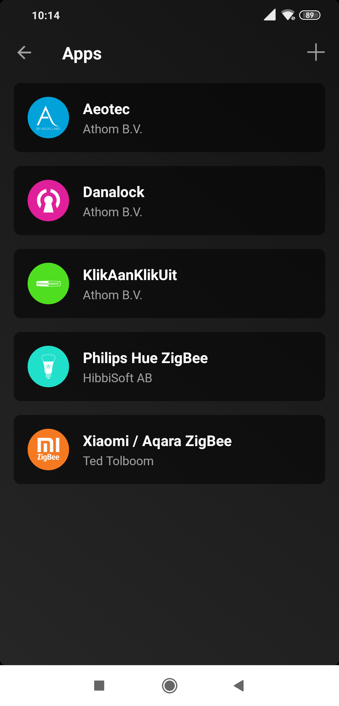

So I got a brand new Homey pro and installed a bunch of apps. No problem only three apps are not in the app list after being installed. Also I can’t install them again. And I can’t uninstall them either. The apps are: group , sets and better logic. All three I can’t find on my homey but when I try to install them again. I get the message the app is already Installed. Using 2.1.2. Rebooted multiple times after install.

Do you mean you can’t find them on the App Settings page? Are they shown here? https://developer.athom.com/tools/app-settings
I noticed your screenshot is from the developer side of the homey, is that a dependency for those three apps? (I edited my original post so people can read the third app)
The third is the group app, I corrected my original post.
The message that the app is already installed I get when pressing the install button in the “app store” on the homey website. But also if I go to add a device and search for group and want to add a group it says the app is not installed and if I want to install it. When I press yes, I get the message it’s already installed.
No, it’s not a dependency, you should also be able to view the app settings in the mobile app (“Meer > Apps > Better Logic”, for instance):
There, you can configure the app.

There must be some kind of bug then. I get the same message when trying to install a new app of which i am sure it was never installed before. Can also tell u the app WILL install anyway.

Yes there is clearly an issue with the app store cause I just got it with an app I never had before
Yes, after testing I can confirm the appstore is not working.
