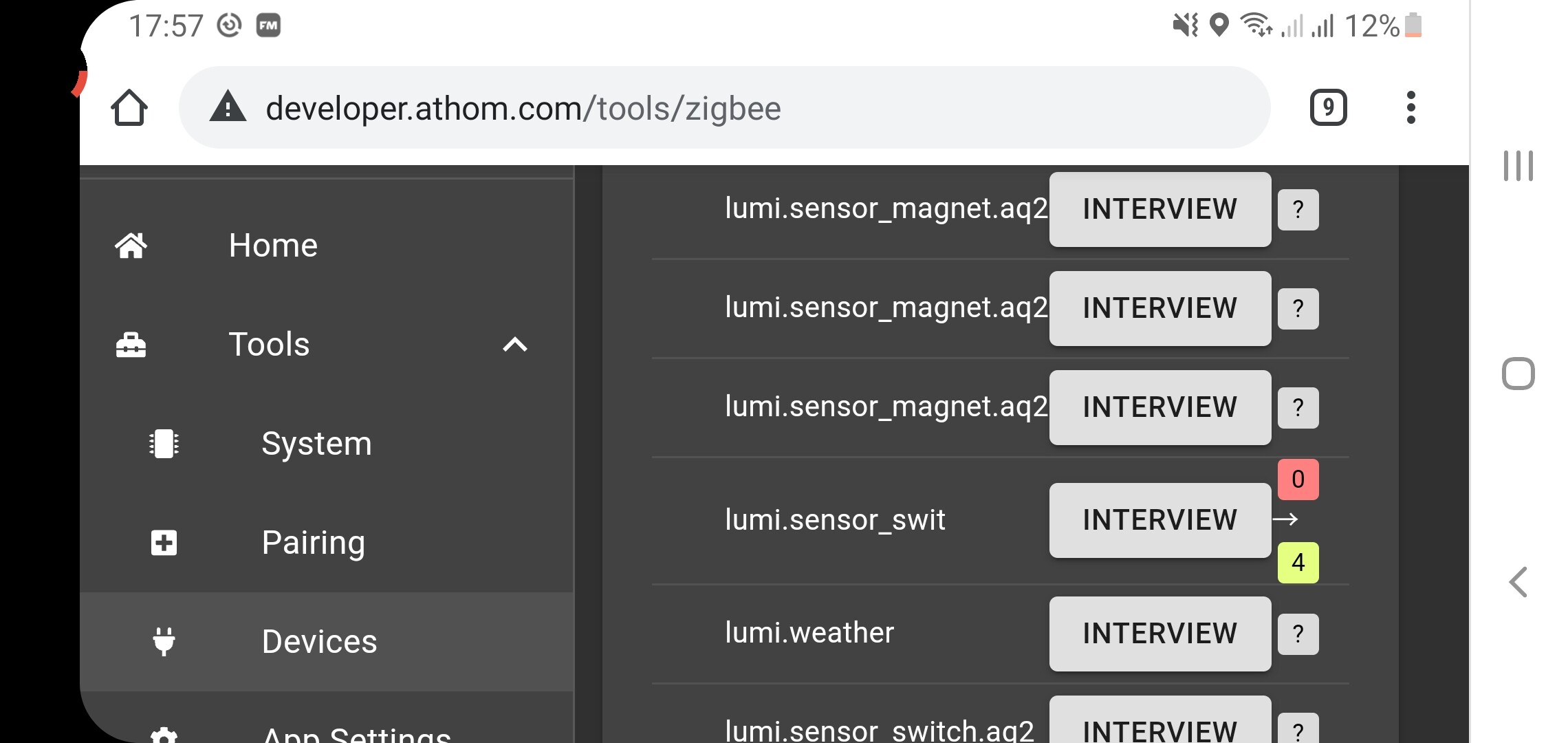

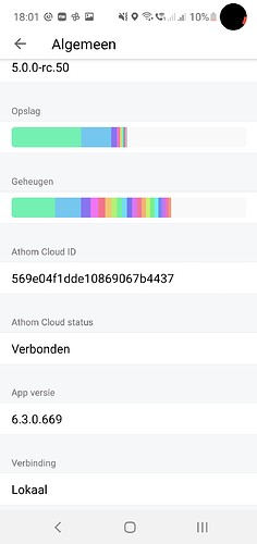

Today my homeys zigbee died two times. Followed this steps and it worked again for a few hours but now it happened again, what’s going on? Running rc.50
