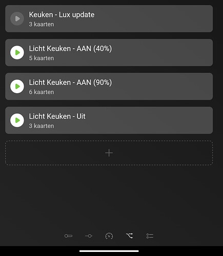

These are the flows connected to this device:
Flows are all triggered by a motion sensor

But in my case, there are no actions (as far as I know) that Dim Light to xx%
All my actions for this device are turn On or Turn Off.

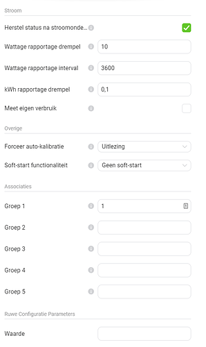

Could I be some Advanced Setting for this Dimmer 2 device?
These are my settings:
No, I don’t think so. But I don’t speak Netherlands and I don’t have a Fibaro Dimmer 2 myself, so I’m not able to identify all parameter.

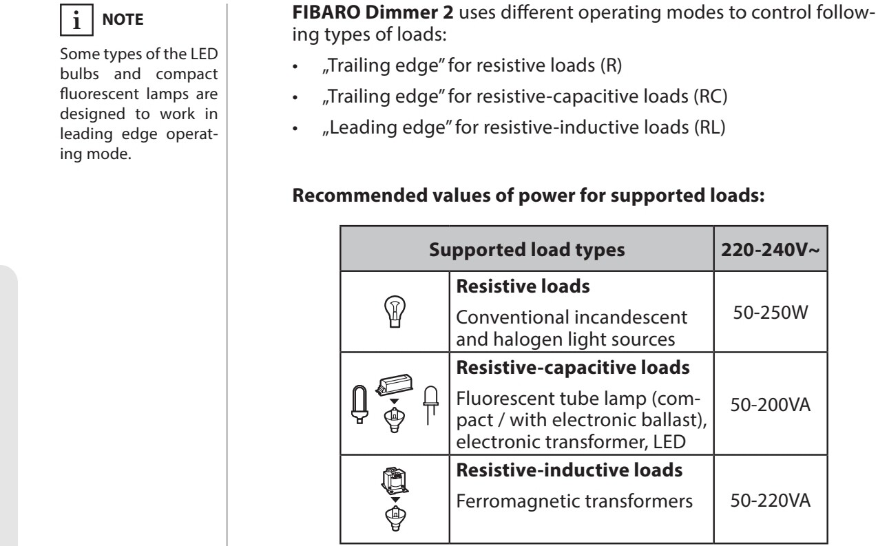

I have had behaviour like this a couple of times. I believe it is due to load-issues (protection). Either too low or too high to handle by the dimmer. Do you have very little load on the dimmer?
Hi @Jo_San
At 90% dim it’s 9.2 Watt
At 40% dim it’s 3.7 Watt
Is that normal?
Ik believe 15W is some sort of minimum load for the Fibaro dimmer 2, otherwise you would have to use a Fibaro bypass (to add about 15W of load). But if the auto-calibration works properly, it might not be necessary.
