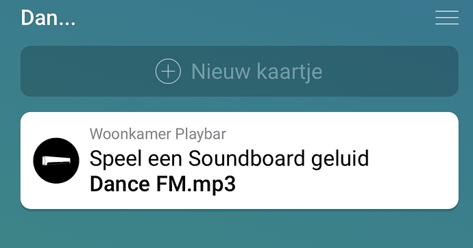

Sonos 5.011 en soundboard 2.05. I use a playbar en sonos 1 en 3, all older ones
They went to a/the new API of Sonos, which only presents those options for the new devices, nothing Athom can do about that, unless they want to revert back, and lose a lot of other options they implemented now.
So you should blame Sonos for not supporting the older devices anymore, but I guess their own reason, people having to buy their new devices, has more power at their side.
I use the same app versions.

Strange that I have the option for soundboard in my flow. Will test it at home.
Just tried it and does work properly.
