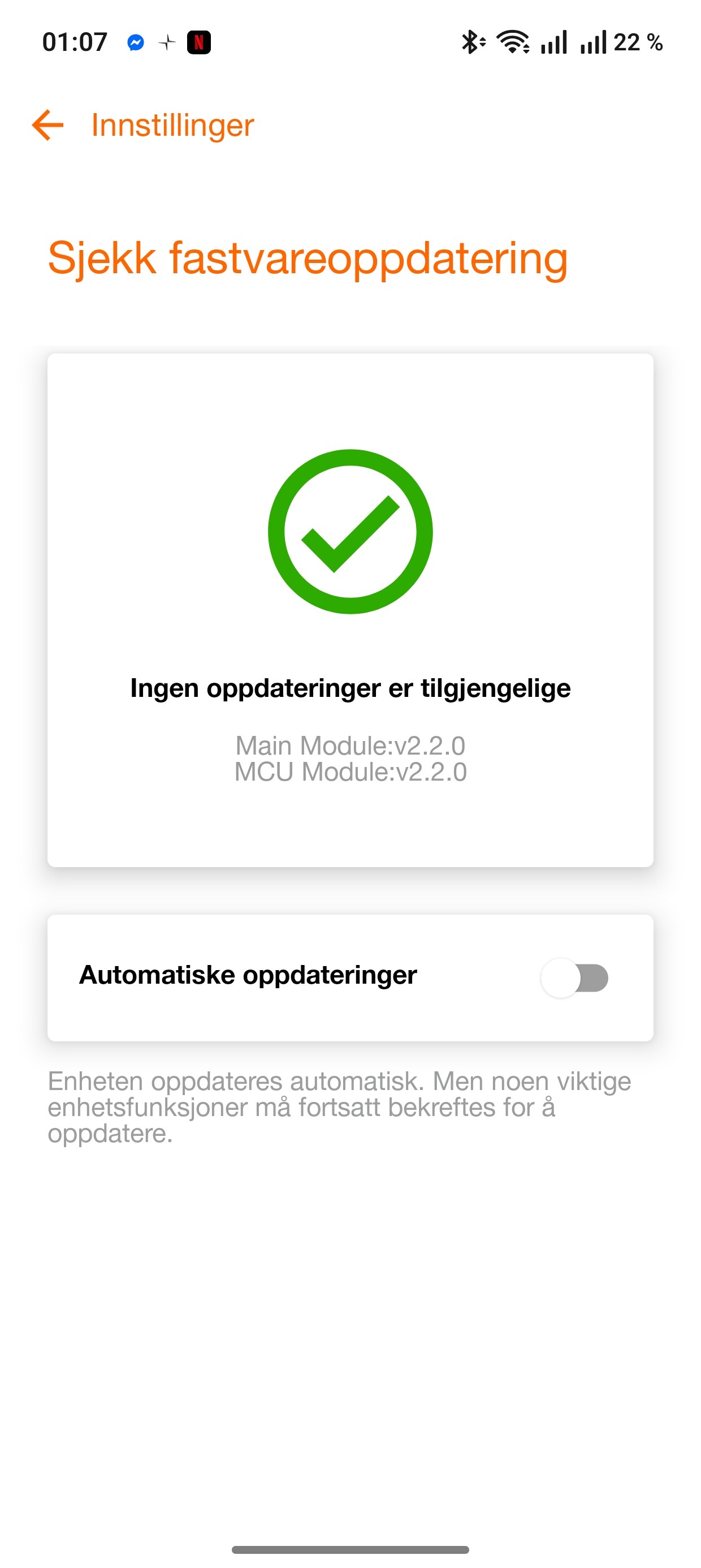

Anyone know anything about Ledvance/OSRAM smart plugs? I removed it from homey and added it to their own app (smart+), but no firmware seems available.

SMART+ is a Tuya-based app, use the Tuya app to use your device in Homey:
As they are Tuya based they most likely won’t use the standard Matter 1.3 cluster for power measuring. Tuya has a custom cluster they use that doesn’t adhere to the Matter spec
So no way to get metering? Or will it work if adding through Tuya app instead of directly(I thought the whole point of matter was the ability to connect directly and everything just works, but seems not..).
Are you sure the ledvance matter-devices are tuya based? I normally recognize a tuya clone-app from 3 miles away, but the SMART+ app looks and behaves very proprietary.
I will try adding the plug as a tuya device instead of the matter way, though I’m not sure how yet. I guess I have to go through the tuya phone app(not just the homey app)?

Yes, Ledvance/OSRAM smart products (especially Wi-Fi models) use the Tuya platform as their underlying technology, but they are designed to work primarily with the official Ledvance app, intentionally limiting direct, easy integration with the broader Tuya Smart/Smart Life ecosystem for Home Assistant and other platforms due to data privacy concerns and to maintain control over their cloud services, requiring workarounds like Local Tuya.
Thanks! Added it through tuya, and its got some metering now - it’s just confused on the scale, so when current usage in W is set correctly as indicator, accumulated consumption is reported 10fold. Guess I have to choose between correct accumulated and correct current usage.
