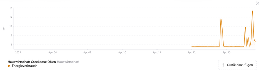

I updated all my 14 Eve energy plugs and connected it to Homey using iOS. Now the plugs are reporting power consumption as expected to Homey:
And here the chart in Homey insights report:

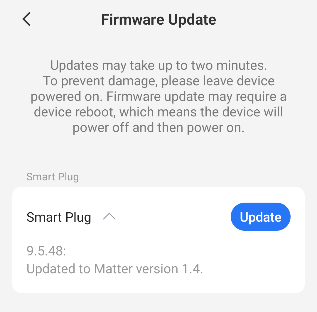

Thanks for your support! The energy consumption is now correctly shown for the Meross mss315 :slight_smile: Great that you were able to solve this quickly and kept us informed. Kudo!
Georg
PS.: Meross even showed a message that the firmware update would support Matter 1.4 now (see below)
FTR: Homey Pro: 12.4.2-rc.7, mss315: 9.5.48
