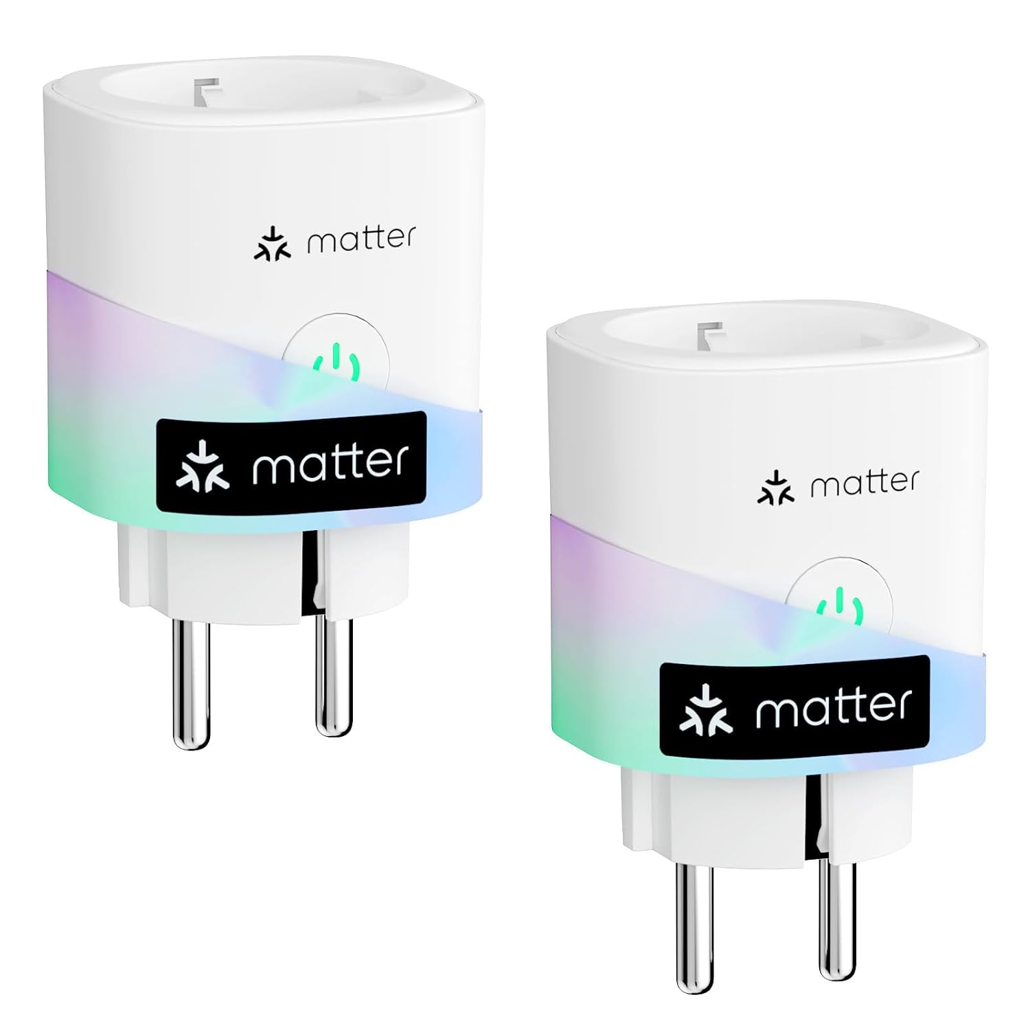

Does anyone know these plugs will work via matter and power measurement
They do work, but only for on/off. They don’t use the standard Matter cluster for power consumption, maybe with a firmware update in the future.
Which plugS you recommend then who have it?

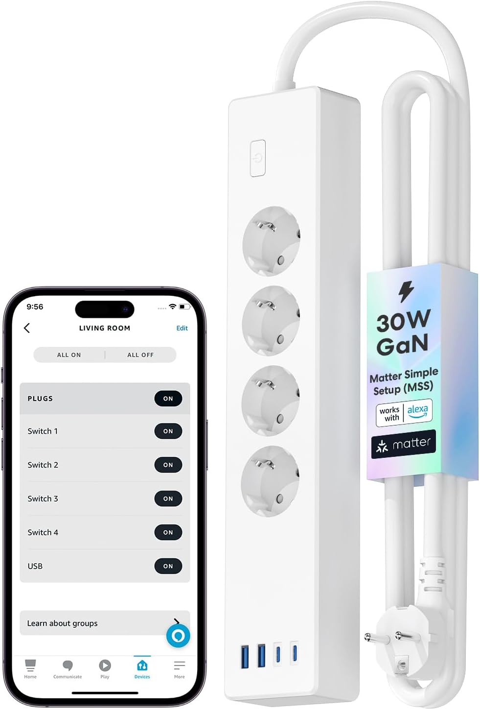

Looks like the MSP844EU. As I mention in another thread, this power outlet works fine with Homey. You get 4 devices for the 220V power outlets, 1 devices for USB ports. And it can be switched on/off. That’s all :slight_smile:
Also energy monitoring ?
No, for the MSP844EU there is no energy monitoring over matter in Homey yet. Maybe I’ve to re-add the outlets. But I will wait until next Homey firmware which should improve energy monitoring for matter devices.
