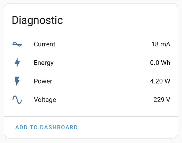

They’re working fine in HA though, I bought 3 for €5 each :partying_face:

It’s interesting—I wasn’t even aware that custom clusters were a thing with Matter. It seems like Tuya developed this plug before Matter 1.3 introduced power measurement support, so they went with their own approach. From what I can see, Home Assistant has done the work integrating these custom clusters.

The Matter server that HA uses supports 3 custom clusters, all power-related: python-matter-server/matter_server/common/custom_clusters.py at main · home-assistant-libs/python-matter-server · GitHub
The LIDL plugs will probably use one of them (I guess the Eve cluster).
