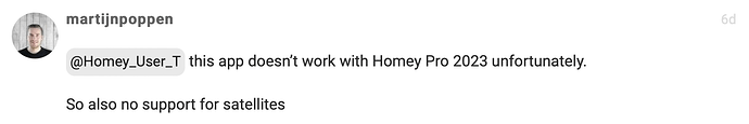

When you still have your 2019 Pro, you can use it’s features like LED ring and speak by using the Homesh Controller/Satellite app set.
Should work with LED it be as well:
