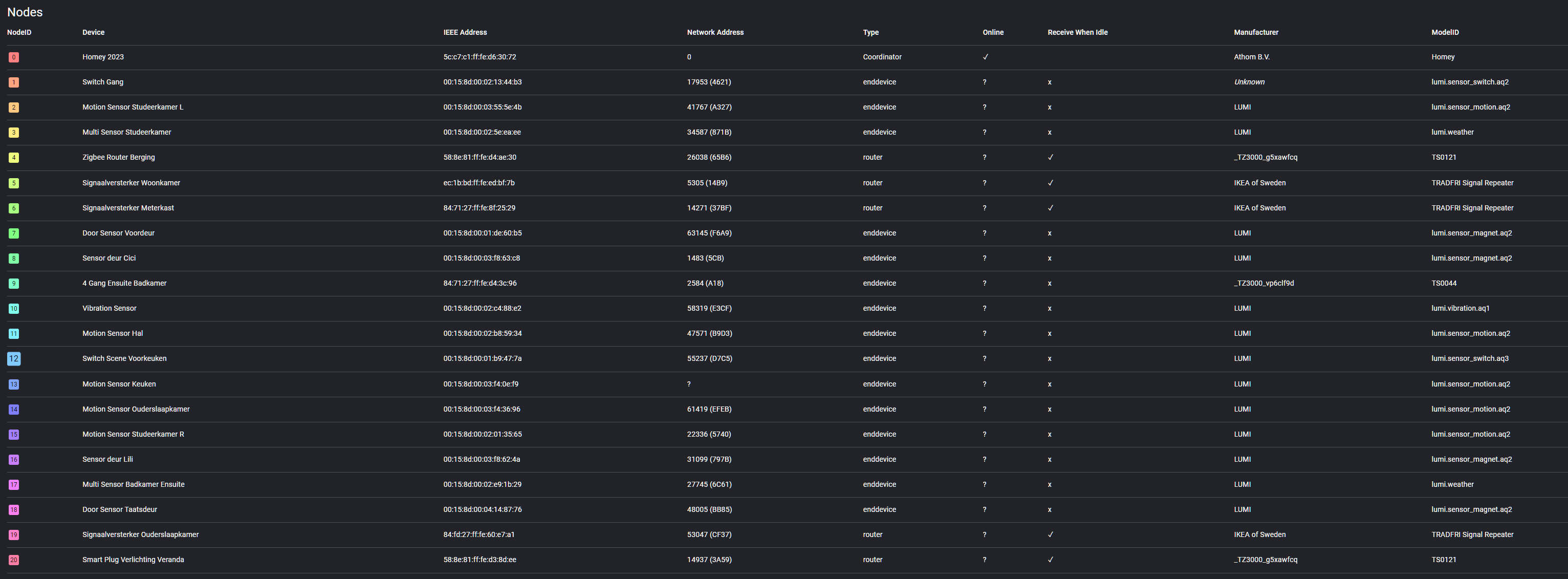

Working all day… moving all my Zigbee devices from deconz tot Homey. I have more that 5 routers throughout the house. Pairing is ok… sometimes it will take several tries, but eventually they pair. To be honest… now I remember why I switch to deconz. The Zigbee of Homey is just as it was in the old days. I was hoping the new chip bla bla would be better in controlling the network, but as usual a proper mesh is not created. Thus now, several sensors are not reporing any value or motion sensors stay triggerd or are not triggerd at all… day lost and will wait another day before i will revert back to Deconz… (never missed a sensor value) i need to add some more but not when the network is so unstable. Yes the new Homey Pro 2023 is in middle of the living room.

Moved my 60+ devices from HP19 + Deconz to HP23 (wifi only) + Aqara/Tuya/Generic yesterday and while I had some issues pairing a sensors, most of them got added fine (to be expected when adding many devices I guess). It has been fast and stable so far, judging by motion + light last evening and this morning. Let’s wait and see how reliable/stable it is over the next few days…
My main gripe is that adding devices in Homey is a real pain because you have to add them one by one, going through too many redundant dialogs. Fortunately this only has to be done once. :wink:
Looks like it’s using 2.4Ghz wifi4 though, not sure how to force it to use wifi5 on 5Ghz (it’s next to a wifi AP). Update: after a few reboots it’s connected on 5Ghz now (developer page).
