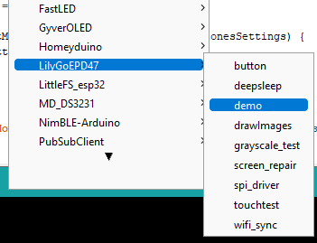

Did you try an example of LILYGO library to check your screen?
not yet, bought it new as i first powered it the sceen went white and it rewrote the info that was on it before.

uploaded 2 sketches… nothing changes on the sceen so is it briked?
Try “Demo” in the example list of LILYGO library, you will have this screen below with an additional line at the end who show the voltage every 5 seconds.
Nothing…
This one:
or this one:
With this parameters:
You get nothing? No errors compiling?
No errors, Upload completing hard reset with RTS pin. is what i always get.
Try on another computer if you can. But if the examples are already not working, I think there is a problem with the board. Contact your seller.
already second computer i try it on, contacted the seller wil be sending it back…
