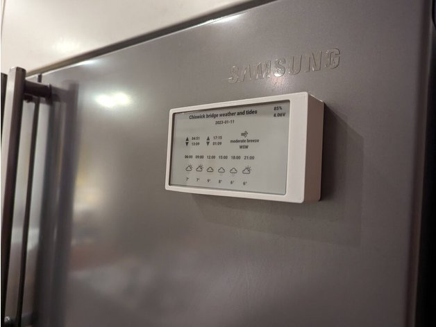

Found a great case for it
This one fits much better, is a bit smaller and buttons are useable.
:thinking: a magnet case is included with this project also… What is so great on the Thingiverse one?
