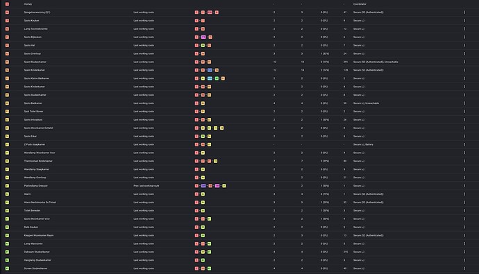

Trust me, Athom has it all. Not only from me. I have shared it before but here again a screenshot, which is just a small portion of my devices. A few minutes after restart of the 2023. This already shows at least 4/5 devices with too much communication. But! It shows the RX number Homey THINKS it’s communicating. Homey is actually itself duplicating messages which makes Homey believe the RX is so high. This is confirmed when (1) looking at the log, which shows the same message from a device displayed 30 times within one second, and (2) because it doesn’t happen at all on the HP2019.

Not very useful to see portion only but I understand you have 200 of devices, which is possibly the biggest ZWAVE network here, so taking screenshot of them is a pain. Btw, if you are using HP23, I would restart again after while to recover from “Prev. last working node” on Node 31, while Node 15 seems to be Unreachable (try TEST) and still, there is quite a lot of RX already for them, so possibly Node 15 and 16 could be misbehaving (or the ZWAVE chip misbehaves with those two)

@Youri_Pasternak , I would suggest to turn of Nodes 2,51 and try to repair Nodes 80 and 81.
If you keep it without those 2 and 51, does the situation stabilize ?
Also I would try to reinsert batteries into Nodes 56,59 and 64.
That’s all I could be thinking off.
