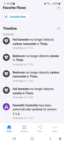

After I added 2 Nest Protect smoke/co alerts (as well as Nest doorbell and camera) with the Google Nest SDM app, I found this in Homey timeline:
The device history says this:
In Nest app there both working fine.
What does this mean? Will the alerts trigger flows in case of heat/smoke/co? Is there a way to test it without actually burning down the house?
Only the first time it sets the values, it goes from null to false, this triggers the alarms…
Ah thanks for replying lightning fast! That makes (a little bit) sense to me.

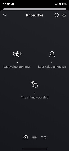

Someone have an idea where I might have gone wrong when the battery doorbell doesn’t feed values to Homey? I’ve followed the guide step by step some days ago, but no values appear.

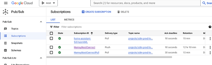

did you also get this message on the nest project? let me check how to set the retention within a day.
We're writing to inform you about a change to Cloud Pub/Sub message retention pricing, effective June 30, 2024. Starting on that date, we'll begin charging for storing unacknowledged messages in subscriptions beyond the first 24 hours. Currently, there's no charge for this within the default seven-day message retention period.
You won't incur any new charges if:
Messages are processed within 24 hours.
Unacknowledged messages older than 24 hours are already retained through Topic Retention.
Please note that storage costs of $0.27 per GB-month will be charged after the first 24 hours
Nee. Maar ik kan me niet voorstellen dat de app unacked messages heeft. Zal een op mijn project kijken
Unacked komt nooit boven de 10m bij mij…
yep put retention to 12 hours , just to be sure, it was 7 days
