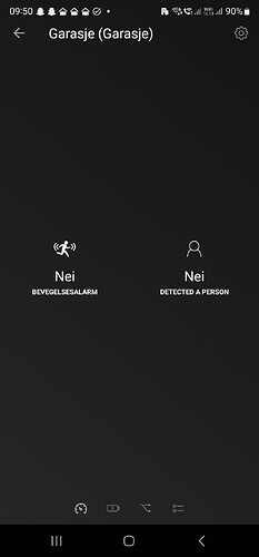

Today i had to restart the app, both camera and protect were not available

Hi, I have 2 wired nest cams and have gotten them into Homey. But no images are generated.
I only get the tag for last person seen by any camera, and it still does not show an image when I try to push this to a notification on my phone…
Tried to search through this topic, but couldn’t find an answer.
Someone know what is wrong?
What version of the app and of Homey are you running? (Not running PRO 2023).
Are you looking for images not generated in the UI or only image not pushed to a notification.
Could you try and push the image and pm me the log.
Martin Verbeek
Homey Pro (Early 2019)
Firmware 8.1.3
v7.2.0 of the app
Will try push an image and pm you the log.
Here is the UI, the same for both cams:
Should the image show up here as well?
Ah…this is the latest wired nest Cam, is it?
If cam shows only in Google Home app and not in the older Nest app, the Google API does not expose an image snapshot
