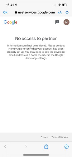

I get this error. I have tried to reinstall the app too :blush:
Hi Nicolas, usually in this case there is a mismatch between users used. Also Google GSuite users cannot be used
https://developers.google.com/nest/device-access/reference/errors/pcm#cant_link_to_partner

Hello Martin
I’ve used the same user throughout the whole process.
