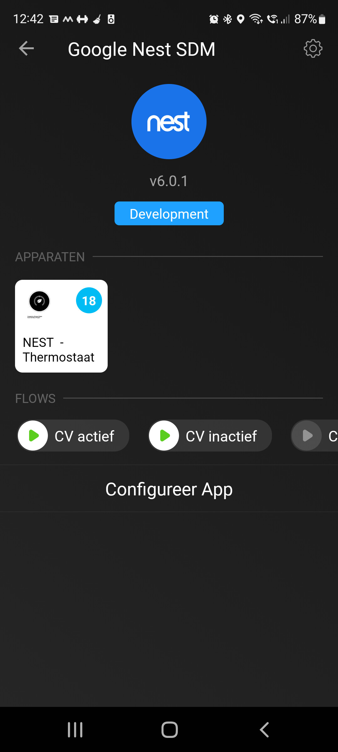

Hi Peter, what version are u running.
Martin Verbeek
6.0.1
i think it has to do with the increment step of 1 degree for the both Temperatuur and Ingestelde Temp arguments. The comparison is against Temperatuur (which is the measured temp) which has 2 decimals and thus triggers an error of an invalid step when used in the comparison.

its not the equation causing the error, but the definition of the step value. have to look into the rounding and setting of the args. no way to avoid in this version of the app.
