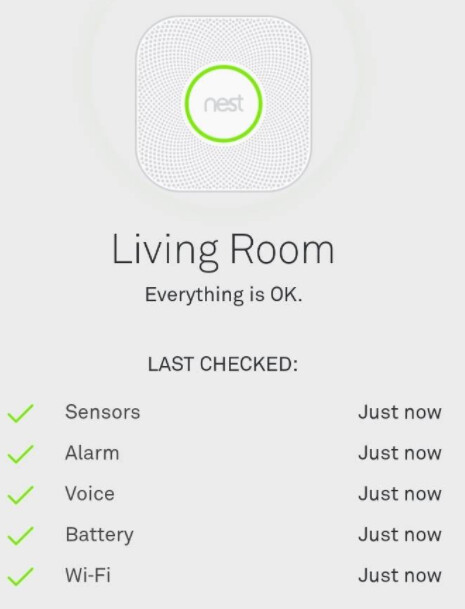

Thank you - hm, maybe I’m not testing it right ?
I created test flow with one trigger, no condition :
I initiated successfully manual checks :
The manual check tags and the flow hasn’t been triggered.

So I requested again NEST Protect Code and indeed it become broken - so another test was successful, the trigger has been triggered but the value in the Nest Protect didn’t get updated anyway.

A ! Manual test updated just now (time stamp)…it took some time, it’s working. :wink:
