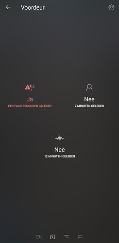

I have a Google Nest IQ Outdoor.
I see the 3 alarms are triggered:
But the screenshots for those alarms (Last Motion, Last Person and Last Sound) are never updated?
Are you getting any pictures?
Martin Verbeek
I see what is happening. I am trying to limit the amount of requests i need to perform to the cloud to prevent rate limiting. I am now discarding events that happens within a second after a first one takes place. will need to change some of that code to make it work better.
Thanks for your feedback.
I did have screenshots. But they were a few days old.
Today I tried restarting the app and now have some recent screenshots.
But not up to date with the “few minutes ago”-alarm-trigger.
I think they are only updated once after restarting the app.
