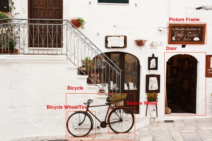

Could you tell more about the ML/AI (Google vision)
See below a description of localizedObjects (one of the 3 ways the app is using Vision). Would love to do the annotations you see in the picture, but the image functions needed for that are too large to keep the app within reasonable size. I am still looking for a simple image manipulation library that fits the bill. You will get the annotation names and location back in the trigger that responds to object moves etc.
When you start with the function, or when you executed a reset action card, it will have an inventory of objects per device. This inventory is a sort of “expected” state. So when the bicycle disappears you can react to it by using a trigger, same when it reappears. Or when a new object enters the scene, and disappears again. The bounds are being used in the app to tell you where the object is found in the image. If you have more than 1 bicycle you would see bicylce#2 as the name that is shown.
Google website text
The Vision API can detect and extract multiple objects in an image with Object Localization .
Object localization identifies multiple objects in an image and provides a LocalizedObjectAnnotation for each object in the image. Each LocalizedObjectAnnotation identifies information about the object, the position of the object, and rectangular bounds for the region of the image that contains the object.
Object localization identifies both significant and less-prominent objects in an image.
Object information is returned in English only. The Cloud Translation can translate English labels into any of a number of other languages.
Image credit: Bogdan Dada on Unsplash ( annotations added ).
For example, the API might return the following information and bounding location data for the objects in the image above:
| Name | mid | Score | Bounds |
| Bicycle wheel | /m/01bqk0 | 0.89648587 | (0.32076266, 0.78941387), (0.43812272, 0.78941387), (0.43812272, 0.97331065), (0.32076266, 0.97331065) |
| Bicycle | /m/0199g | 0.886761 | (0.312, 0.6616471), (0.638353, 0.6616471), (0.638353, 0.9705882), (0.312, 0.9705882) |
| Bicycle wheel | /m/01bqk0 | 0.6345275 | (0.5125398, 0.760708), (0.6256646, 0.760708), (0.6256646, 0.94601655), (0.5125398, 0.94601655) |
| Picture frame | /m/06z37_ | 0.6207608 | (0.79177403, 0.16160682), (0.97047985, 0.16160682), (0.97047985, 0.31348917), (0.79177403, 0.31348917) |
| Tire | /m/0h9mv | 0.55886006 | (0.32076266, 0.78941387), (0.43812272, 0.78941387), (0.43812272, 0.97331065), (0.32076266, 0.97331065) |
| Door | /m/02dgv | 0.5160098 | (0.77569866, 0.37104446), (0.9412425, 0.37104446), (0.9412425, 0.81507325), (0.77569866, 0.81507325) |
