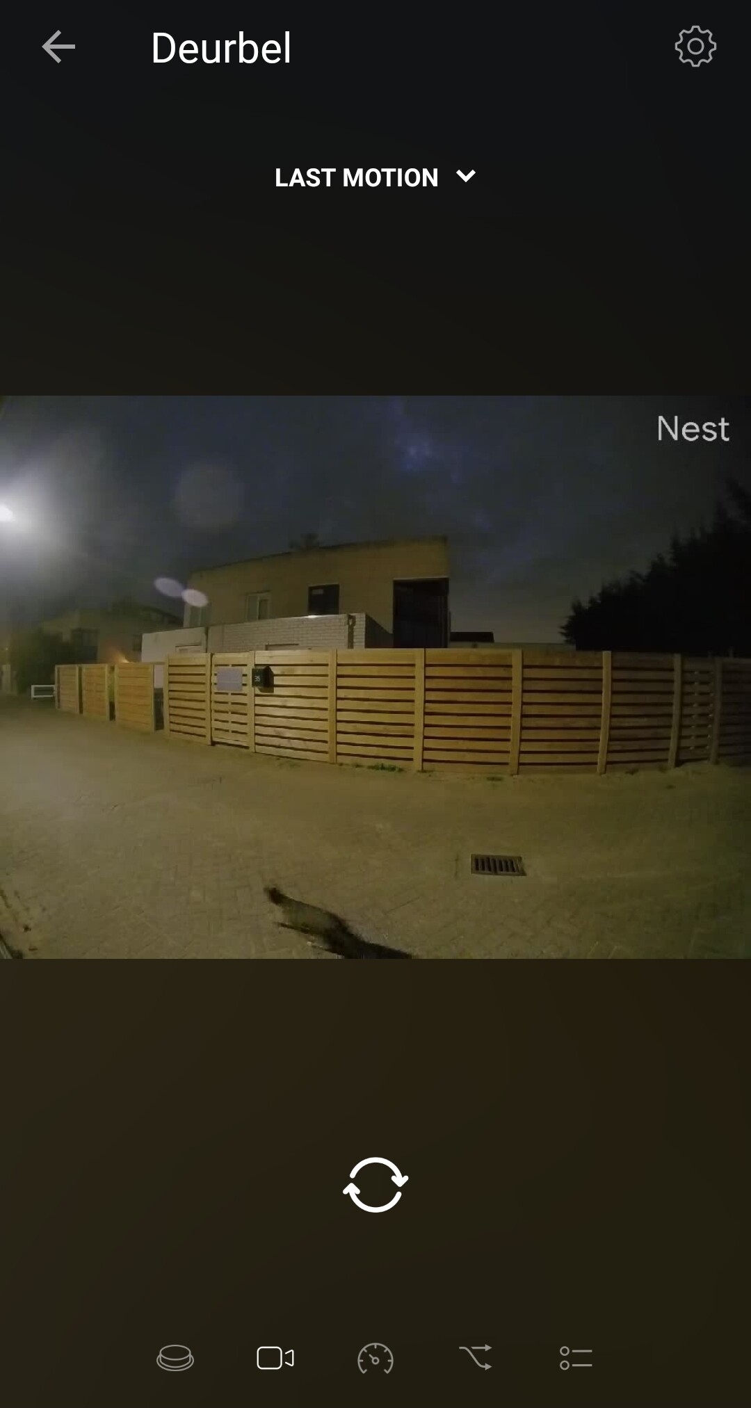

Is it possible to disable the motion detection?
I am sure it’s disabled in the Nest Hello doorbell.
But a neighbours (terror) cat constantly triggers the flow that turns on the lights in the garden (zone active) :face_with_head_bandage:
:smiley: Will add it as an action card so it can be conditional.
