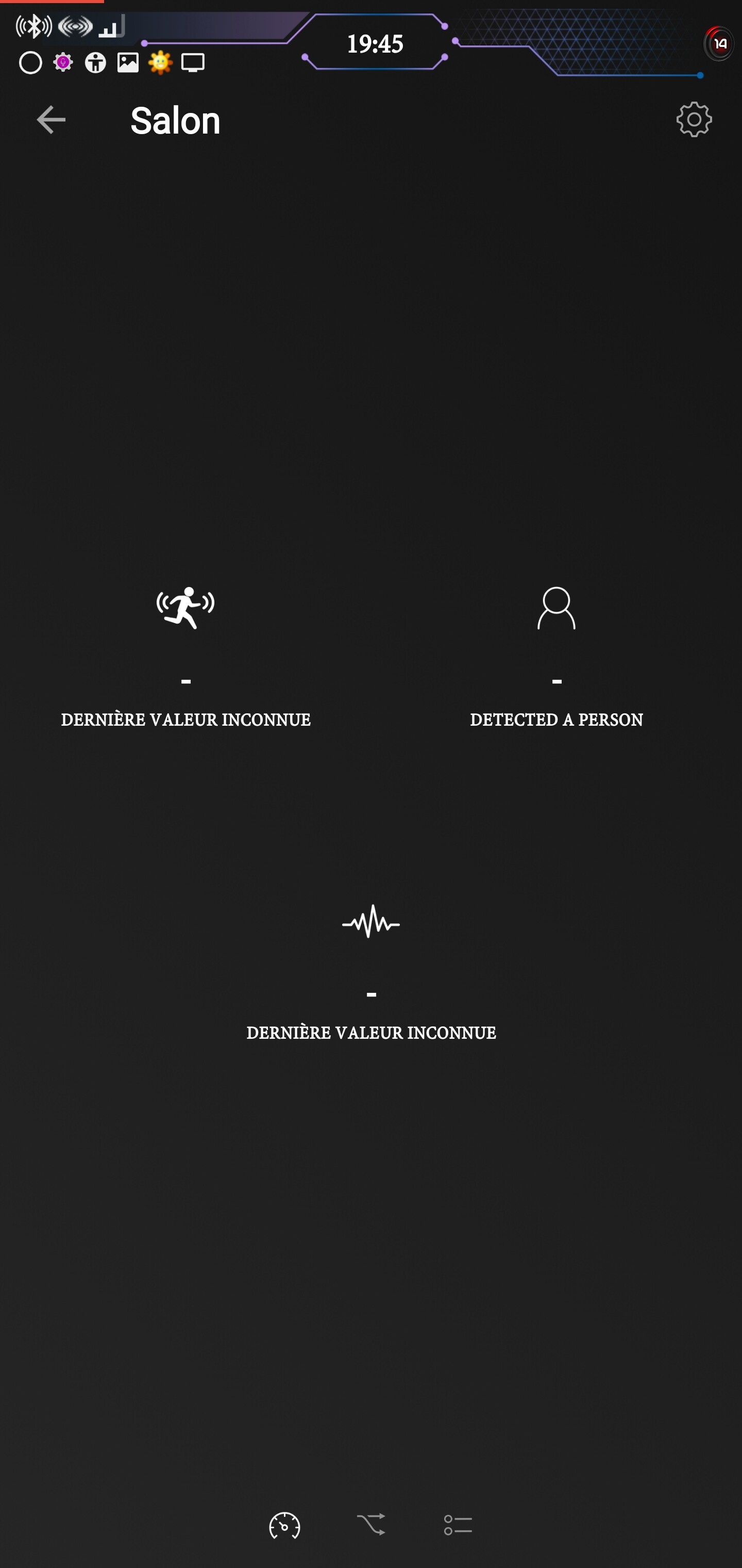

Yes,it worked perfectly a few days ago,problem is started 3-4 days ago when i notice the yellow exclamation doesn’t appears when i walk behind my nest max…

Hello Martin,after 2 days,still the same problem with my 2 hub max,when i walk behind the hub no motion detected by homey,nothing appears on the log,only the motions of the Nest hello.
I try to remove hubs from the app and reinstall but no changes
I have the motions notifications of the Nest app.

Strange,yesterday i try again to remove the devices and reconnect them after,hoping my hub max will worked but same problem :the app discover my devices(hello and 2 max) but only motions of the hello are seen by homey.
I didn’t uninstall the app by the way,just logout and login after.
