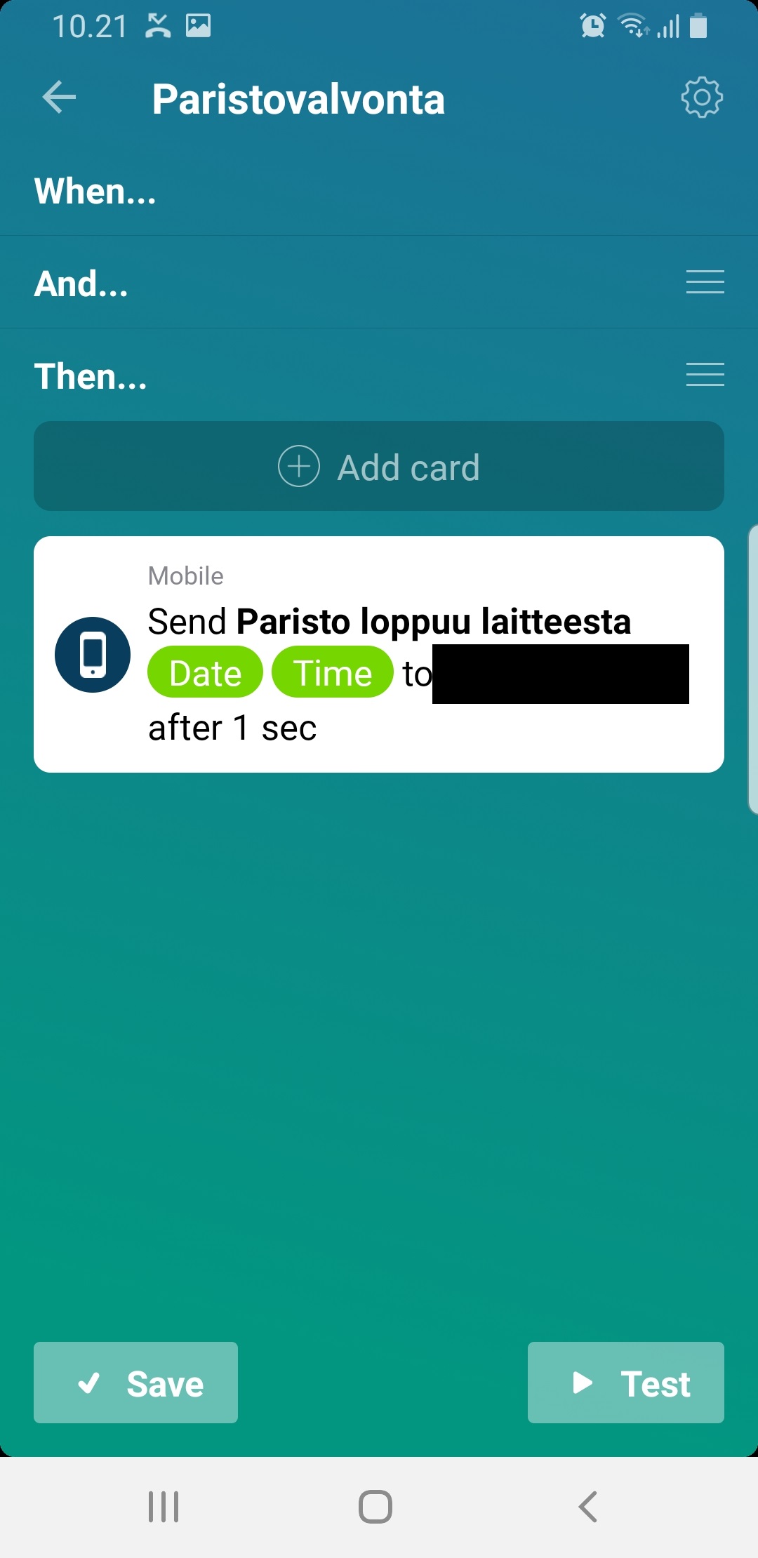

I have this flow. It worked, but not anymore. I don’t know since when or why.
https://homey.app/f/vyXMQL
For me the same flow works without any problems.
Maybe restart Homey (I guess PTP is not needed) or build this flow new.
