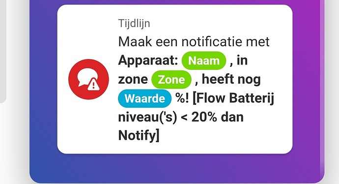

@Undertaker Just a couple of questions to the flow you shared.
What does “[[Text]]” do? Is it just formatting?
As far as I understand this is a timeline notification? How come you have a red icon? Mine’s yellow. Care to translate the text? I think google translate had a smal embolism trying to translate it for me :wink:
I felt free to answer your question.
That is a Timeline notification.
The phone app shows indeed a yellow icon, but when you share a flow, it suddenly is a red icon. Why? > support@athom.com
The freely translated text:
Timeline
Create a notification with
Battery [local tag “Name”], [local tag “Zone”] just has left [local tag “Value”]%
I don’t know what the [[text]] part is, it seems part of the German card description, not something entered by Uwe.
Example of my timeline card, in Dutch
