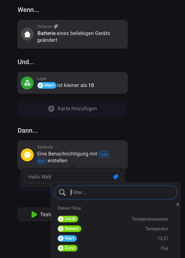

But of course it’s also possible via flow(s).
The When… flow card can be found here: When… → Home → Cards → (Sensor) of any device changed.
(Sensor) is a drop down field where you have to choose Battery.
To ensure that the correct tags (device, sensor, value, zone) can be selected in the timeline notification, the previous flow cards must already be connected to each other. If you click on the tag symbol in the text field, then the relevant tags can be chosen:

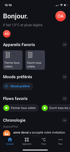

I cannot find how to activate notification for low battery.
Here is what I see under Timeline (chronologie in French", no “ENERGY” under timeline
I also tried this scrren, but still no ENERGY section…

Hm, strange! I know that some timeline categories are only available once a first timeline notification has been sent. Unfortunately, I cannot answer whether this is also the case with the energy category, sorry. Maybe someone else knows more about this.

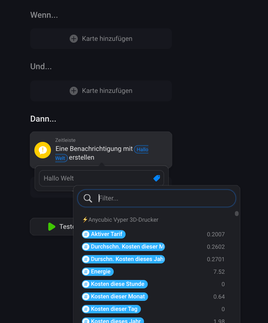

With a normal flows it’s more or less the same way:
However, it’s also important here that the previous flow cards are already available.
If you insert first the timeline notification flow card, then alls the relevant tags are missing:
