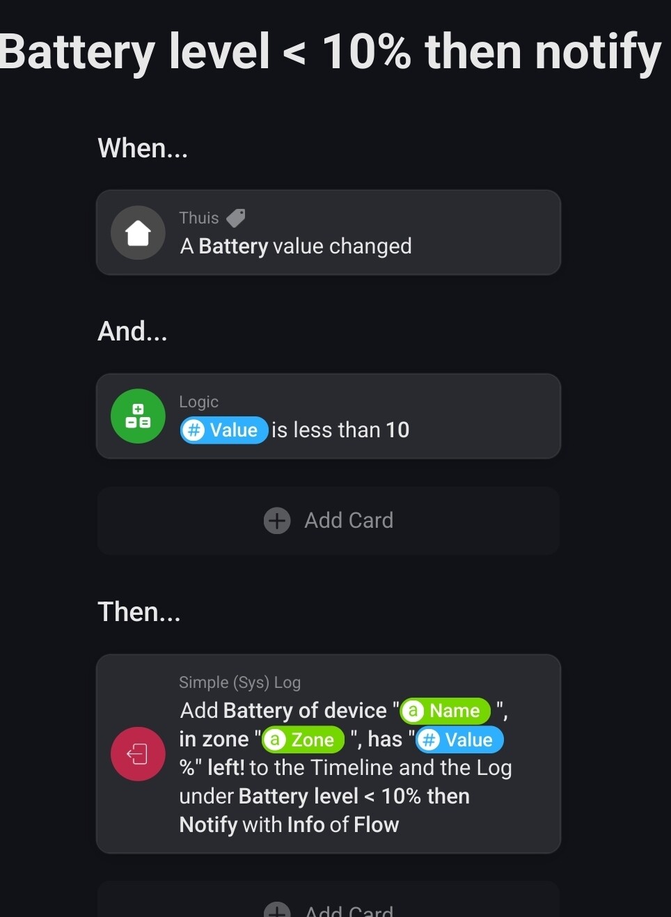

Besides using Hscript there’s an onboard solution as well:
@Peter_Kawa Very interesting! I currently have separate flows per battery device to monitor and inform me of a (custom) threshold. This flowcard would allow me to replace them with one flow. Do you know since when this flowcard has been made available? I haven’t seen it before.
Owww, for me it’s been there since I bought my 1st Pro 2019 back in 2020.
BTW (maybe you knew alr) Homey automatically notifies you when a battery is below 20%, but it’s sent to the timeline only (or with push notifications as well if you have it enabled).
However, there’s this trigger card “when notification was sent”;
with a logic AND card “contains battery” you can send the notification to “anywhere”.
