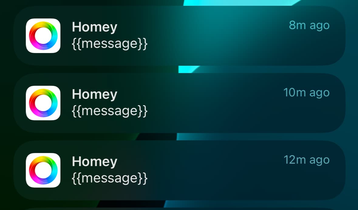

The script works fine and when testing, it exactly shows the right devices. The flow that actually sends the push message, looks like this:
For screenshot purposes I left out the user. De message information generated by the script does not show in de actual push notification (it just shows this):
How do I solve this?
