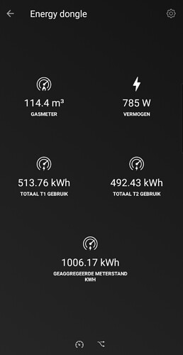

My meters now look like:
So back to normal it seems… :slight_smile:

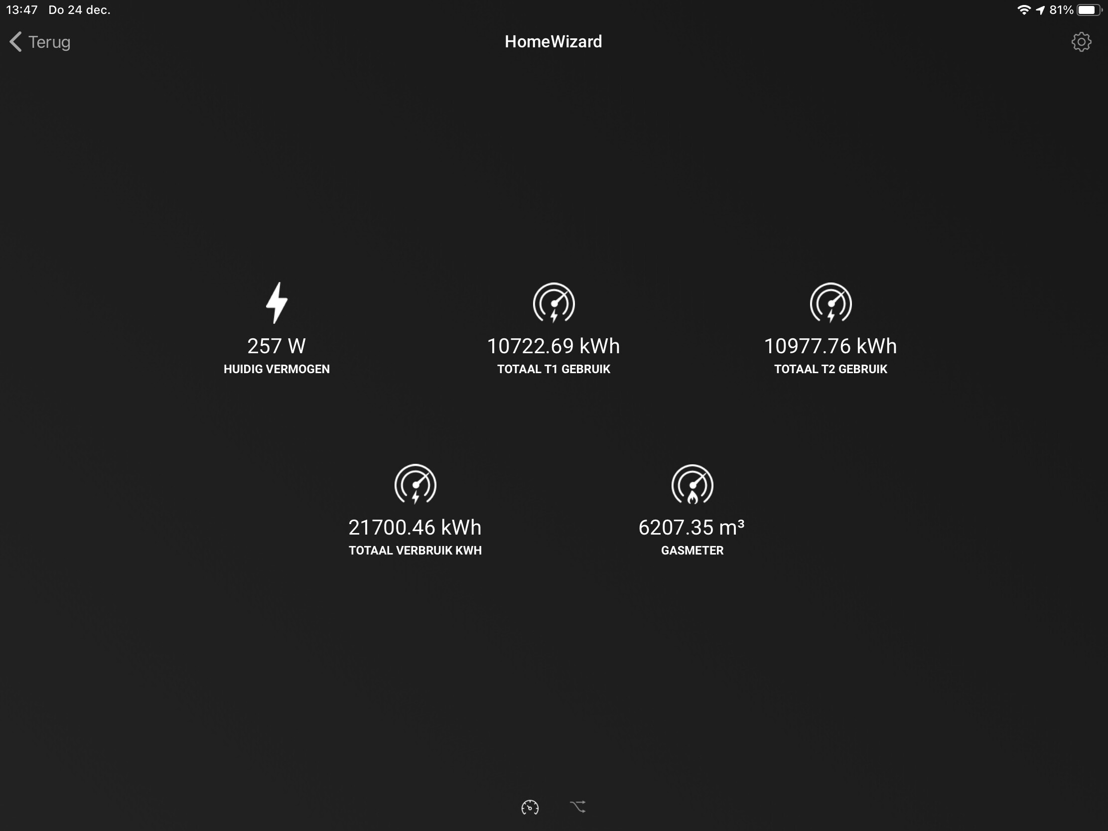

Looking good!
Bit clearer now what is meant…
Thx @Jeroen_Tebbens!
