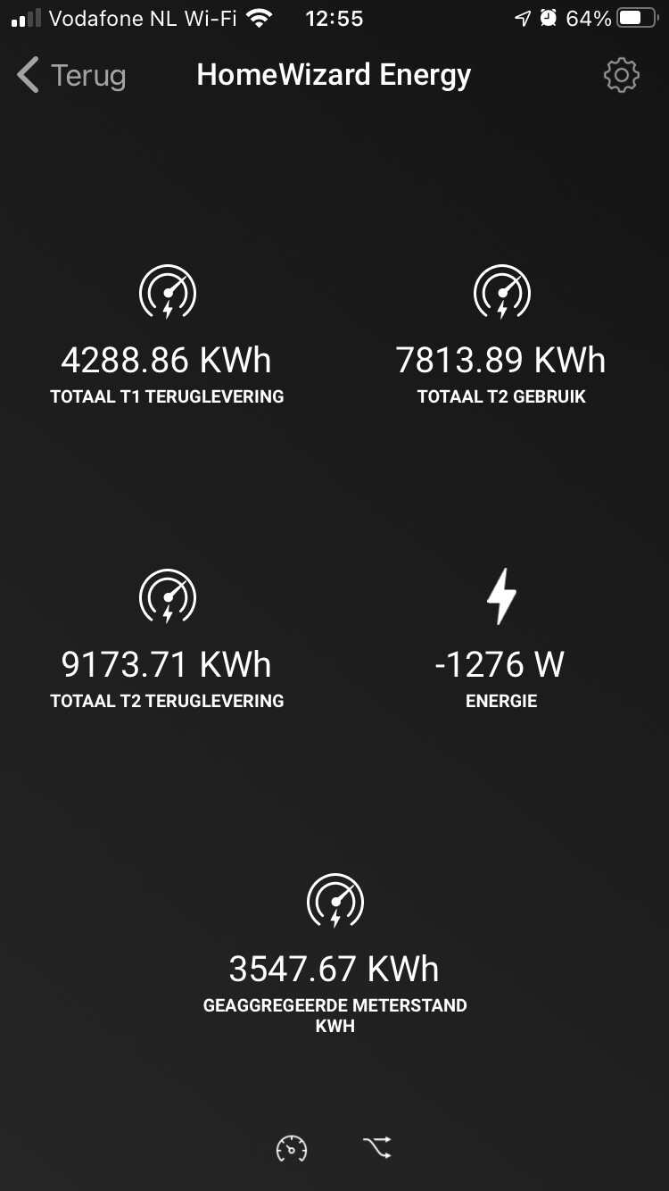

Now as you probably know in Belgium they changed the return power to the net 1:1 last week…
So i was wondering if it is possible to make homey switch on consumers when the value “consumption” is going in negative? (So when we have more input from the solar panels then we have consumption)
Thanks,
(Not sure about forum hospitality here so i use English ISO Dutch)
Yes it does (see image). Sun is shining and the energie goes negative and thus delivering back to the net.

Hello Jeroen, i am using the app now! it works great i was abble to add the flow to switch on a heater when the energy is smaller then0 . (nog niet kunnen testen wegens geen zon in Belgie XD) I do not fully understand al the info that is on the board, the picture you post has a different layout, can this layout be changed?
Edit: i think i see that you got another (test)/version. :slight_smile: currently installing that one!
Which picture do you refer to? Some users don’t have a solarpanel or deliver back to the grid. Also some have 3 phase powerline and hence it will show the meters on the device dashboard. Sadly, no you cant change the order of these meters there.
