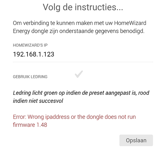

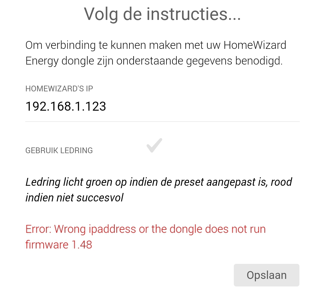

I have a new dongle and I cannot add it to Homey
When I try to add it, I get the message “error: Wrong ipadress or the dongle does not run firmware 1.48”
The firmware error could be correct. My dongle came with V1.50
Below some more details of my setup
Homey FW 5.0.0-rc 38
Homewizzard energie app v0.1.5
Dongle FW 1.50
Are homey and wifi dongle on same subnet? (Or be 100% that 80/tcp is allowed between homey and wifi dongle.
Another thing could be an accidental space in the ip address field upon adding.

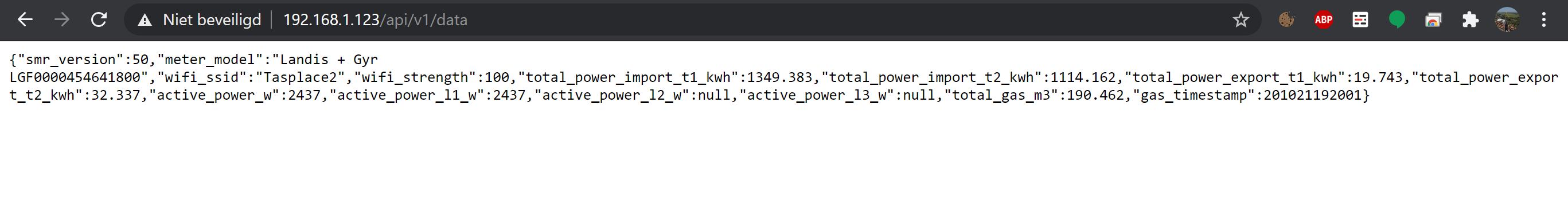

During pairing process I check for smr_version != null which is fine with anything above 1.48 firmware.
I”ve not tested this version with Homey 5.0.0 so cant relate if there is a new issue here.
Should be fine from what I see from the API response.

Yes.
Extra checked. This is not the case.
It really doesn’t work. I also restarted everything, router, Homey and dongle.
Nothing helps :frowning:
I see there is a new issue, will check tomorrow.
Try this older version to add it.
Yes 0.0.7 works :partying_face:
Thanx :smiley:
Good, that means the pairing portion isnt working in the newer version that I need to fix.
