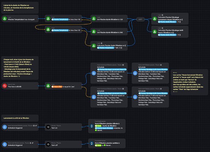

For those who are interested, here are my flows using the Action Scheduler app :
I could have done this using BLL but I’ve choosen Action Scheduler as I find it much easier to use for people like me who do not know anything about IT coding ^^
Once again, thanks @OH2TH :slight_smile:
