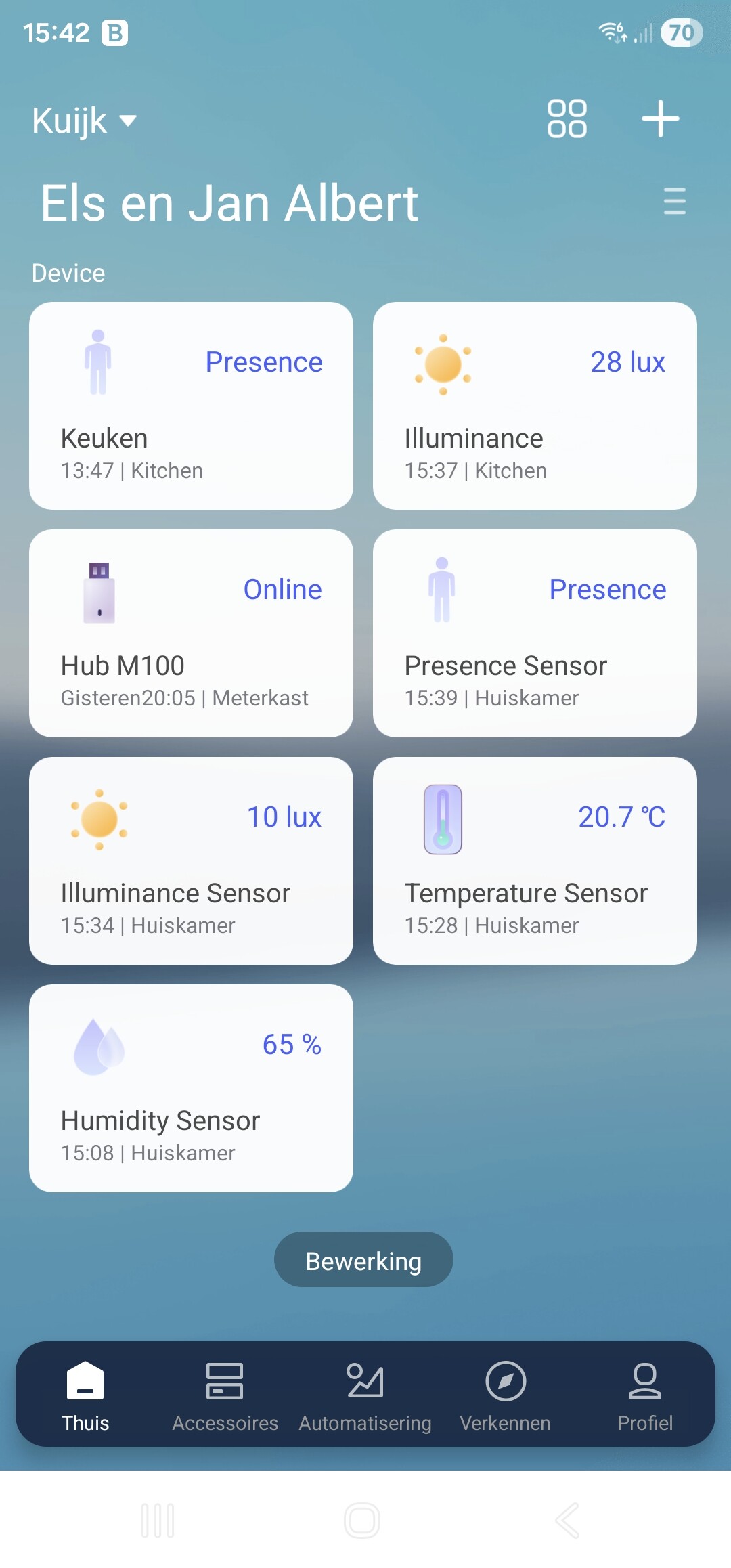

This is my dashboard of the aqara home app

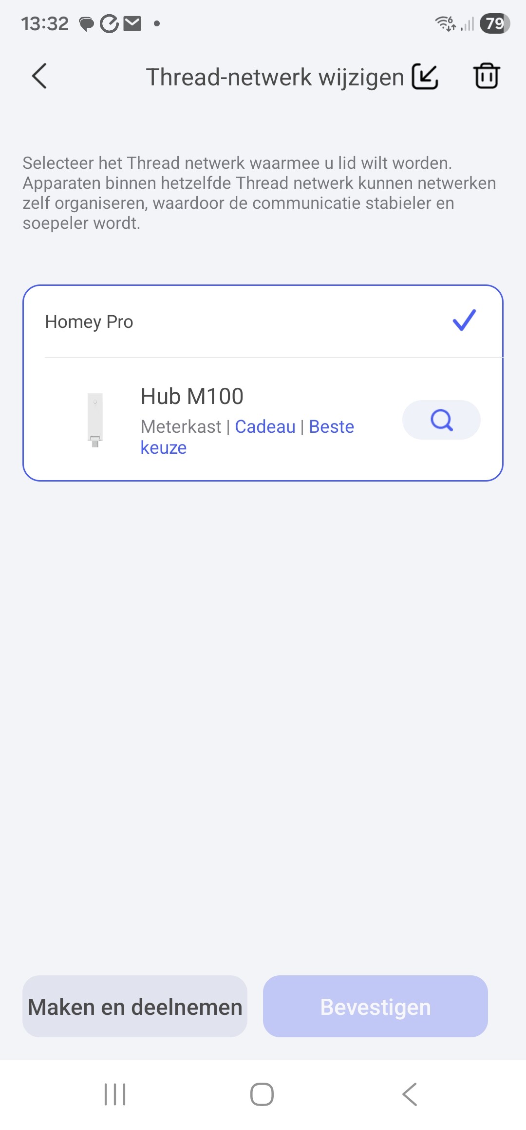

I went a little different route, but seem to have the 300 working.
Put it in the aqara android app via the 100, then shared it with homey. I am getting immediate presence and absence readings.
Then you use the aqara thread network. I use the homey thread network. Result is the same…. I get this in the Aqara android app:
