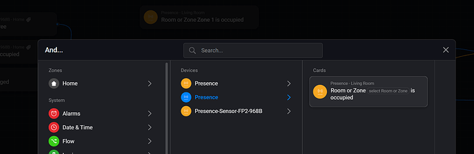

I’ve got 3 fp2 sensors. The third sensor doesnt have any AND cards sadly:
The other 2 sensors do have them. Any idea what’s going on? I had an error when adding the last sensor. It said something like Error M2: 7? Does it have to do anything with the room type i configured in the Aqara app?

I’ve removed it from the aqara app, resetted it with the button at the bottom, readded it in the aqara app and after several tries with the Homekitt app i go the same error message (error m2: 7). It got added to Homey, but again it’s showing me no AND cards in the flows.
Any idea? My other 2 fp2 sensors don’t have this issue.

Many apps don’t have AND cards, or just a few of those cards;
Here, Homey Logic steps in
Please read my earlier posts. I do have them with the other 2 sensors. See the screenshots.
Could this be the reason you have no AND cards.?
I’m pretty sure it is, but its up to Martin Verbeek to fix those. I’m sure he’s on it.
What I also try to say is that when error codes occur, it is no wonder things go wrong. So you have first to resolve the error code, and then the missing AND cards, if they are still there. As you have two sensors installed without errors that are working ok, I would suggest to install the 3rd one again until it installs without errors.
I’ve tried reinstalling the last sensor 3 times. Resetted it to factory settings in between. At some point i give up. I’ve tried what you are suggesting.
