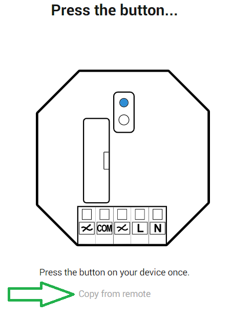

Depend on your Device, What device did you want to re-pair?
At least in the latest version of the app I see it for some devices:
This is now in Version 7.3.2, guess added here mor than a years ago:
7.2.0 - 7 okt 2021 - Added support for the ACM-300H2, added the remote copy functionality for multiple devices and minor stability improvements.
