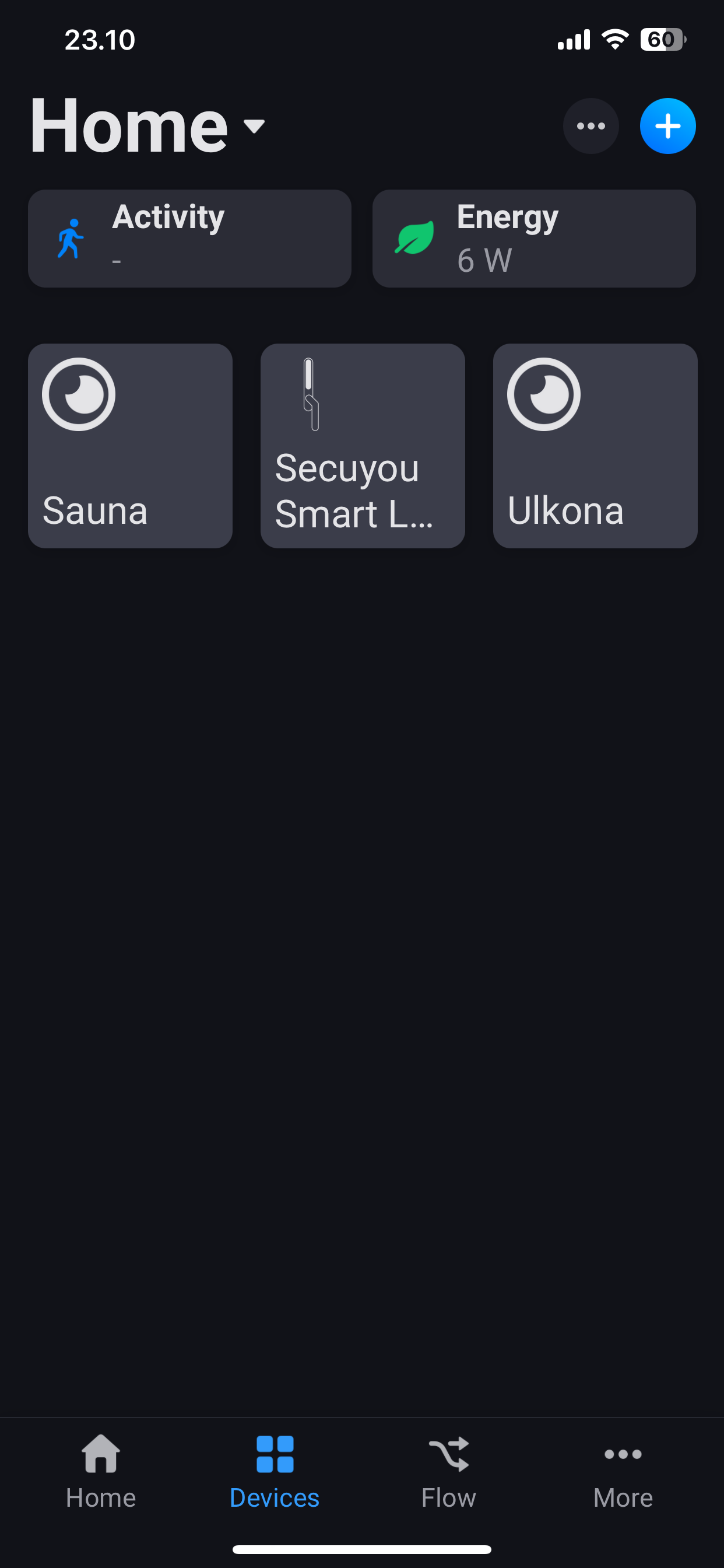

Hi @secuyou

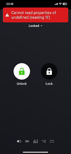

Is the homey pro 2019 still supported to secuyou smart lock? I can’t connect it to the homey.
It shows error code. I put some pictures of issue. Is there any help for connecting issues?
Lock works with ios phone app, but not connecting to homey pro. Edit, new user can’t insert more than three messages and only one picture in a message.
Here I try to push those unlock / lock buttons after I push that Secuyou smart lock icon

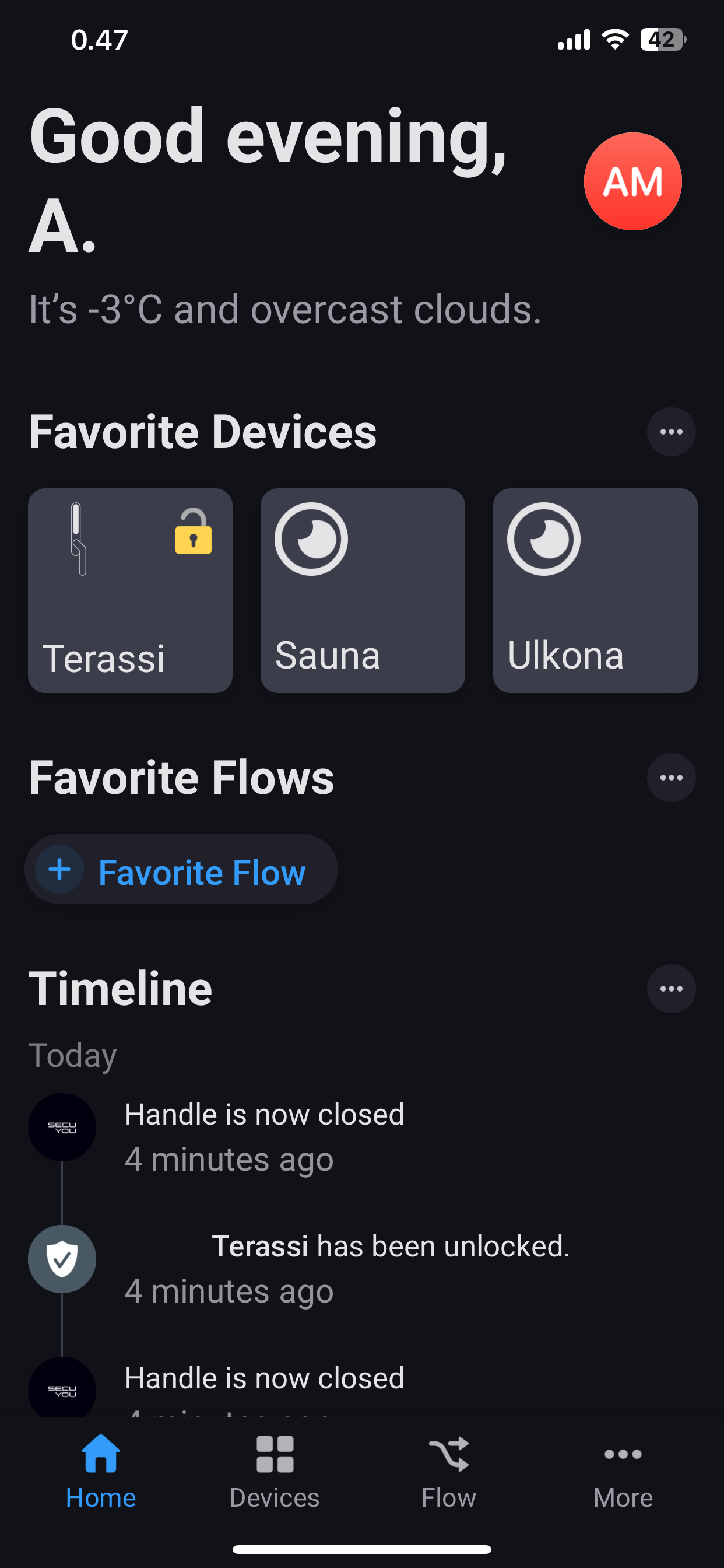

@Secuyou
After 3 hours the homey and the lock became to communicate themselves.
I named the lock in both app to Terassi and after three hours the yellow lock icon appears inside homeys smart lock icon. It works, hopely it still works tomorrow also.
