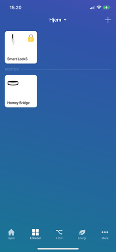

When you add a lock to Homey then it can take a while before it is connected. Therefore wait until you see a lock (yellow) in the icon. View attached picture.
When you see the lock icon then you know it is connected. First then you can lock and unlock.
