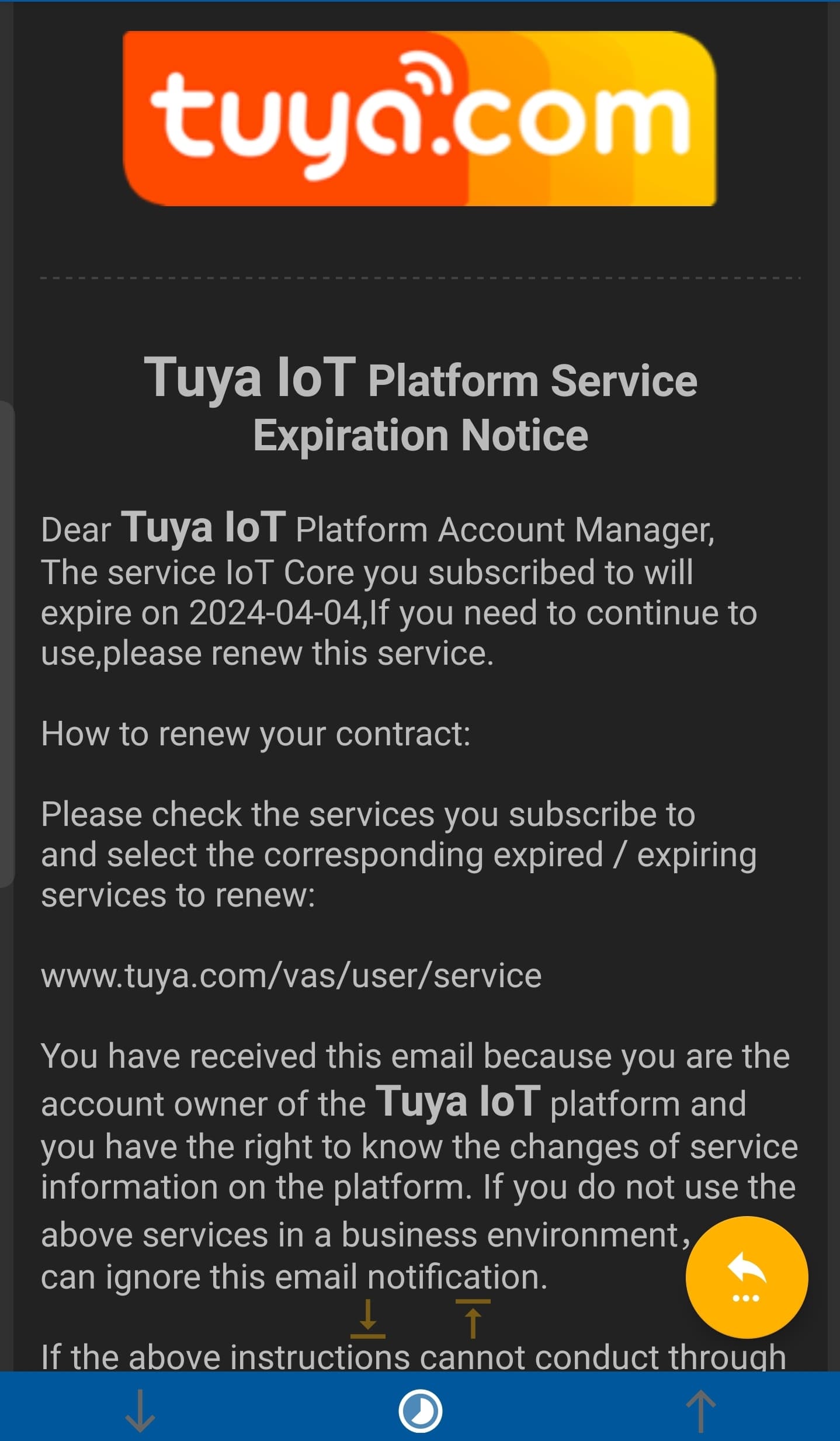

Most probably your iot trial period has expired, and needs to be renewed.
Search post 1 for “iot trial” for instructions.
Tuya should send email reminders for this.
Example:

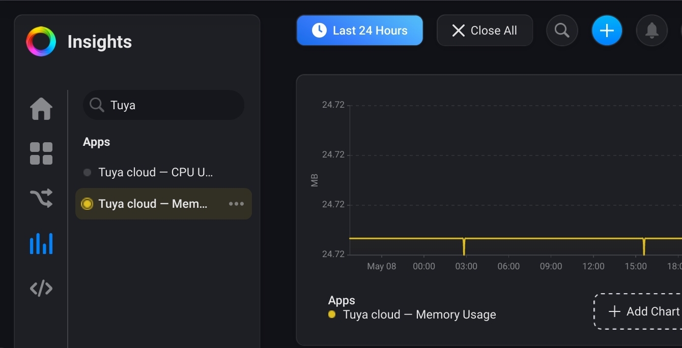

  5. Can you show the insights app memory graph of the last 24h
    How to find it:
(Make sure you’ve enabled Experiments > power user)
Tuya cloud app is v1.1.23
Homey pro 2023
The behavior in the app differs per occurrence; once it was running still but trying to “save” settings in the app it gave a super weird error (didn’t screenshot it) until I restarted the Tuya Cloud app, then it worked once again.
Second time (couple of days later) the app itself was still running and even clicking “save” in settings worked but it did not receive any device updates until I restarted the app.
So in all scenarios the app still remains available, including the flows.
Memory week/day;
