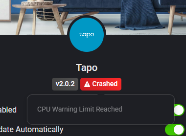

I had been using a mix of this Tapo app with a Home Assistant provided device for each plug, using one for on/off commands and the other for the monitoring,
I noticed today that local auth was now available, so I switched to using that and then replaced all my previous devices with these. The good news is I can now have on/off control with the energy monitoring, which is much neater.
The problem I am having is the app is crashing pretty regularly. The app screen gives me the tooltip ‘CPU Warning Limit Reached’. The app then restarts, works for a while, then crashes again.
I have created a diagnostics report, the code it gave me is 7d997dd7-c08c-4237-a1c3-62dedbb04187
I did notice this message as I wanted to add another Tapo device to homey. I don’t see this on the Tapo homey app page unless I misunderstood something there.
I did enable this on the Tapo app and was able to enable local connection now. Seems to be working fine since last night. Will keep monitor this for now. Hopefully this is it so I can have more frequent updates on power monitoring.
I haven’t had issues with the app crashing but I’ve been using 2.1.4 which is the test version. I’m using a homey pro 2023
Hi Meax, Thanks for your message and diagnostic report. It looks like the device session is expired all devices want to re-auth at once. I will have a look at.
Do you have experimental build enabled? Then you can try to install version v2.1.5. In this build the app spreads the reconnection logic with random delay to prevent CPU spike.
