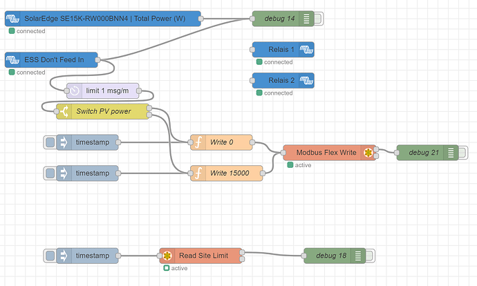

My Solaredge HD inverter (with display) is not responding to active power limit set anymore.
I hava a flow that worked flawless, bu now with negative prices again, i get the notify from flow that inverter is set to 0% but when I look the inverter is still 100% active power limit and not 0%
|I started that flow 5 times manualy but it does not work.
Inverter is connected, all the settings are set, and it worked a short while aga when price was negative as well.
Report : 5644b004-afe8-494e-a50f-f62bbf5a1e3d
your report looks fine and did you also define that solaredge will control it , in case of negative prices?
Normal solaredge device , no meters or battery did not have a change some months. So it looks like solaredge reverts your changes. Plus it worked before, can you try this from the inverter menu?
If you have solaredge with meters and optional a battery , you can now use production limit , this will dynamically control activer power to meet your export demands.
something like this. (this is flow action)

indeed, you give now solaredge total control instead you are the boss with homey. solaredge will overrule you.
But I did not have any settings there I just filled them just now. Should I remove those settings or leave it ?
Met vriendelijke groet,
Mike de Vries
you can try to use those from solaredge and specify all your values. then solardege will do the same.
else you need to disable it and do it from homey .
and check the inverter values of rrcr .
can be you got some update from solaredge and this disabled again. Or solaredge does not want you to do it yourself . make a support call to them and find out what is going on here especially when it worked before.

Well i tried a lot of things.
All the settings are correct, settings are active, modbus is connected, app is updating all available info, but sending the command to set active power limit 0% does not work (anymore).
I have opened a case just now, for this and hope it will be solved are a least clear what is the case here.
So frustrating that it just like that does not work anymore.
If this is because solaredge did something remote without informing me than I will disconnect the inverter from internet access.
I like to be in control myself!!
