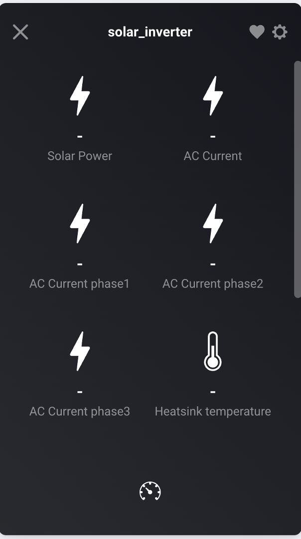

Just added my Growatt Mod 4000TL3-XH to the Solar Edge App. The inverter connected well but no values are displayed. Any suggestions what I can do?

hey,
just to be sure did you do this , it does not have modbus support out of the box.
and also can you send me a diagnostic report

Solar Edge just mentioned a couple of weeks ago that they are supporting Growatt as well. However I have SoloarEdge at my house in Switzerland and here the screen looks the same. No Values
The App connected very well to the Growatt and Solar Edge system bit does not show anything

it is about modbus tcp, all inverters work the same , only different registers mostly
do you have modbus installed and enabled like in the pdf? and more stuff is coming to control your inverter.

Need to ask the Provider if modbus is installed. I habe no idea just installed the App on my homey. Will Check let you know
probably not , this is a hobby solution and not a professional device. you can buy it somewhere
