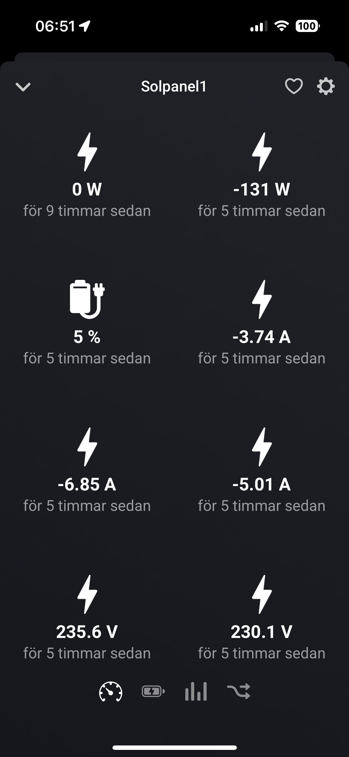

Hej! New to this app, I got the connection to work yesterday, but I get the data quite random.
Have 2 inverters with battery on both. (Huawei with WiFi dongle)
One inverter (nr 2) gets data a little bit more often than the others, but I never know when… the other gets it very seldom…
Any idea what could be wrong here? When I added them to homey the configuration asked me to set the polling frequency but I can’t find that setting anywhere. I don’t have anything else connected to the modbus, did configure it for the first time yesterday
