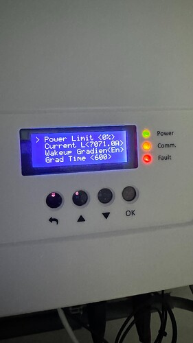

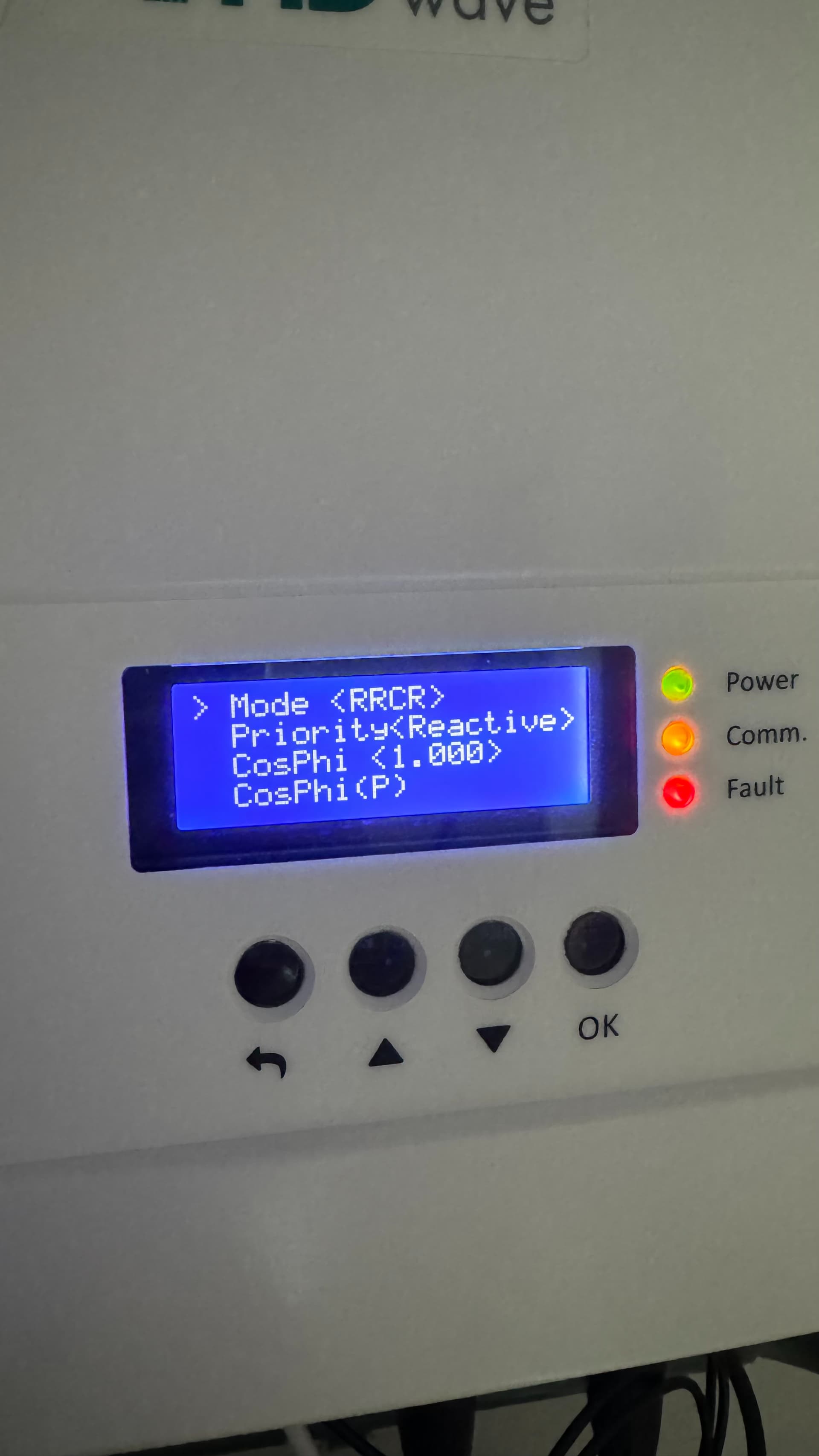

that is weird. can you put it on 0 on the inverter and send me again report
b6024aca-f0d9-4632-8b0d-ae83b8adb411
when you do this from the inverter , I see powerreduce = 0 and not active power.

maybe because the inverter is not producing power?
I can do it again tomorrow when power is produced.Now the inverter is in sleep mode
Shall I do this again with power limit to 0% tomorrow?
yep or you did the wrong menu item , but else I can also add power reduce also to see if that works better.
In this report the power limit is on 100%
6c8f57c1-3a6c-4e83-a151-bc1fa8ef785d
and this report active power limit is 0%
65d59bc4-3a0c-46d2-ba3b-c790f01d18e6

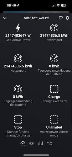

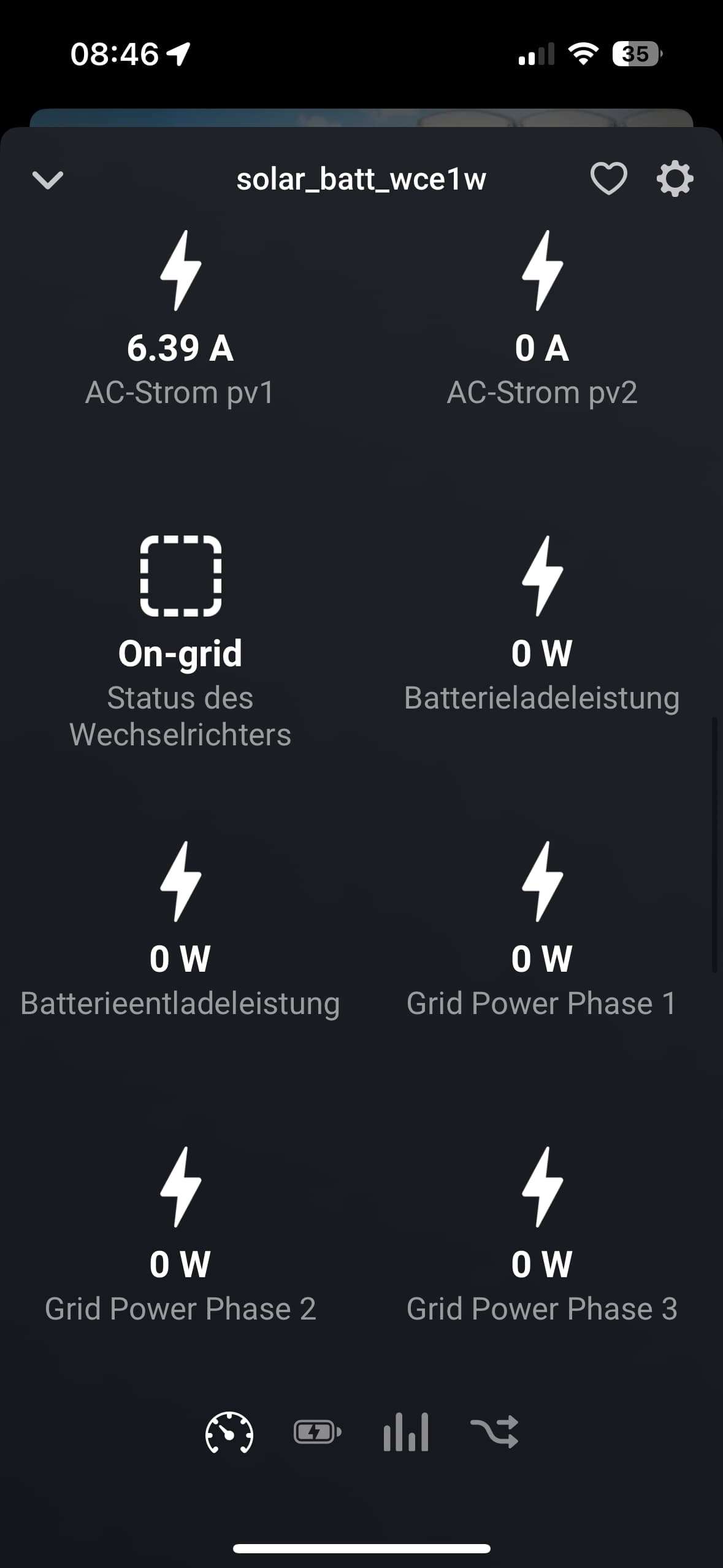

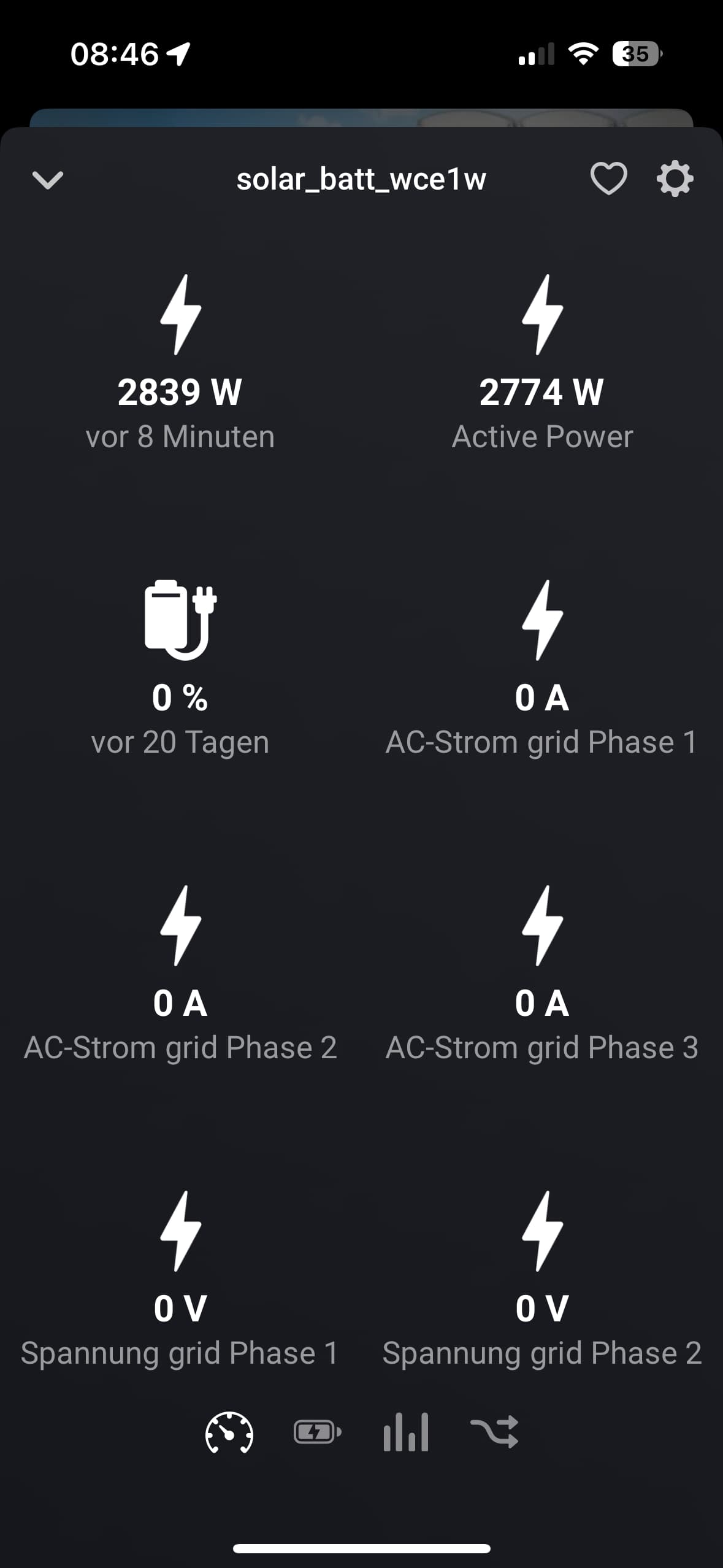

Dear People.
I am running a Homey Pro (2019?), using Solar Edge + Growatt TCP modbus.
PV: Converter Sun 1x6000,1x4000 (logial 1unit), wirde Dongle (RJ45), Smart meterDTSU66-H, Battery Luna 10.0000
Config: IP-Adress of Converter, Port 502, ID 1
Problem, I See several data but not all. especially Battery % are missing). Ideas are appreciated.
Kind Regards,
Felix

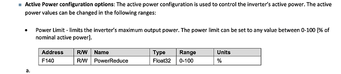

thanks looks like you use power reduce instead of active power. Can you ask solaredge which 1 is best and what is the best.
in the mean time I will add power reduce for you.

yes, looks like it so I will add power reduce also. Maybe now solaredge prefers power reduce instead of active power.

I am using SolarEdge+Growatt TCP modbus
IP: Internal IP
Port: 502
You can see in the attached fields that many did not fill. Is there anything else I can give a try with. Anyway mistake I make, any work arounds? The Entry via Webpage isn´t alive anymore, right?
If you need some more information, please let me know.
Thank you very much for your help.- it´sappreciated!
