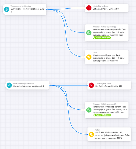

I tried this 2 flows to lower the power output when the dynamic electricity price is less then 0,10 Euro.
Wit a manual test the solaredge invertor does not react, power procucing keeps the same.
Reading out the power state by modbus works fast en great.
Do i need to do more for controllling the power output this way?
THX!!!
You can add in your SolarEdge app you have a dynamic contract.
I am in contact with the SolarEdge customer service and they claim you should activate this.
( my Zonneplan contract will start in July so I did not tried this.
According to them setting active power limit does not work otherwise.
Ok!
Thx, I will try that.
interesting for me and Richard it works on a older inverter but not on a new one
looks they introduced something new , mine inverter is from 2021
