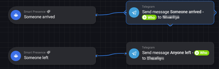

Tested multiple times on my side right now, used both triggers Specific user-Someone left / Arrived, always got the trigger - no issues :man_shrugging:.
Can you for troubleshooting purposes create primitive flow like :
And when you notice that flow hasn’t been triggered to send me diag + name of device/state, which hasn’t been identified ?

Eg. this is my test setup - every-time time, tested with 3 different devices and all state changes were captured correctly.
obrazek
