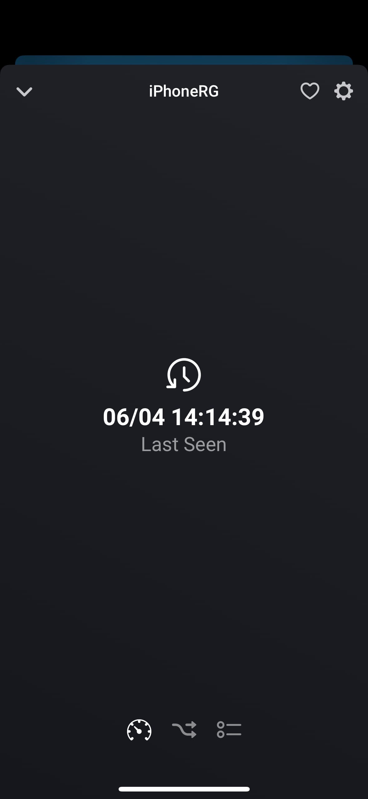

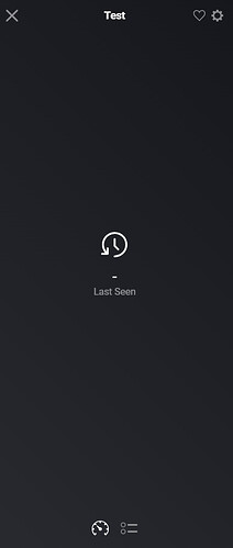

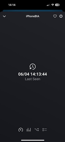

I send you 3 screenshots

What info is given in this screen for the phone of Beatrice? Also in the screen when you choose the other option?

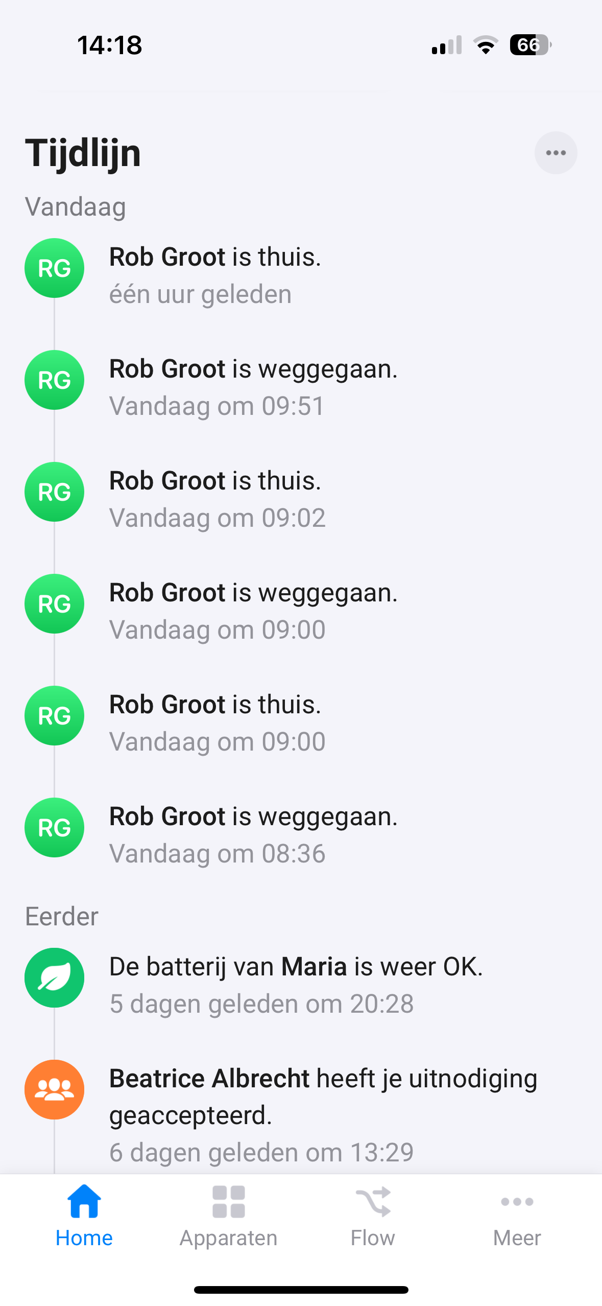

And, as you can see: we left together but iPhone BIA is not in the presence/away list…
I was also interested in the screens under option 0 ---- only from Beatrice :slight_smile:
