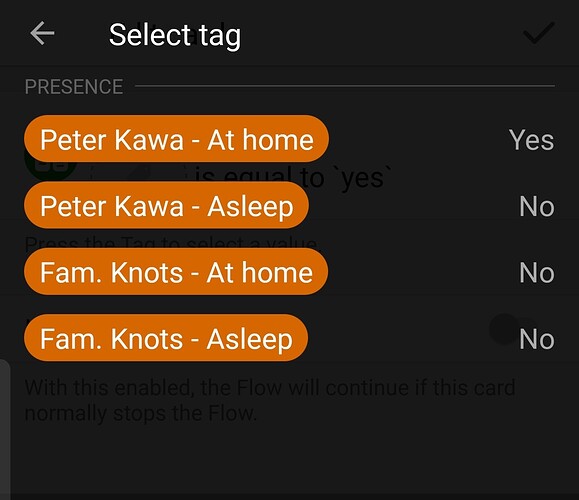

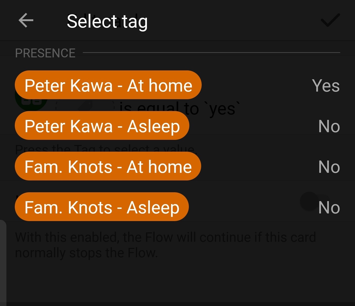

Somehow there’s no logics Presence tags available at the “AND” section.
So my thought was to create and control presence variables via flows, while you can use those at the “AND” section logics cards.
Yes this is the only way I found so fare, but had hoped that there was a way without creating so many flows for something that simple.
But it seems like I need to go this route then
