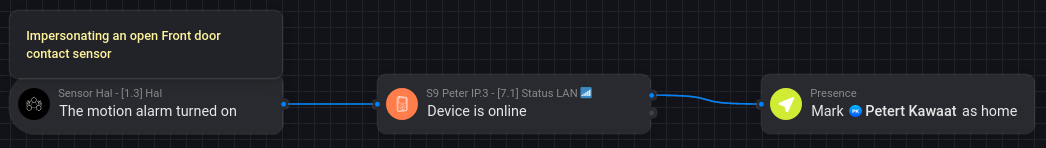

But now I would like to run a smart presence scan so it determines at the moment the door is open if a person is home or not.

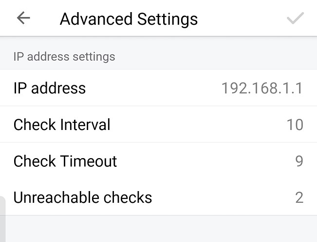

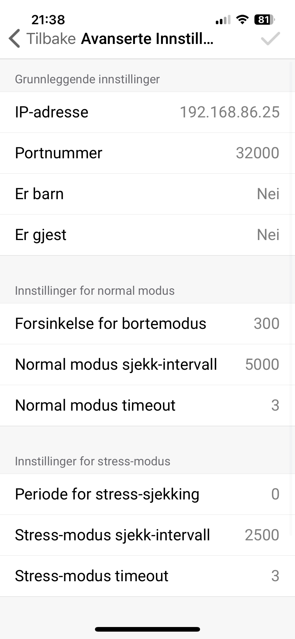

What values have you used for members/devices. I’ve messed around a bit with this and can’t remember now what the default setup was. Does anyone have experience and recommendations in relation to this?
(sorry screenshot in Norwegian)
