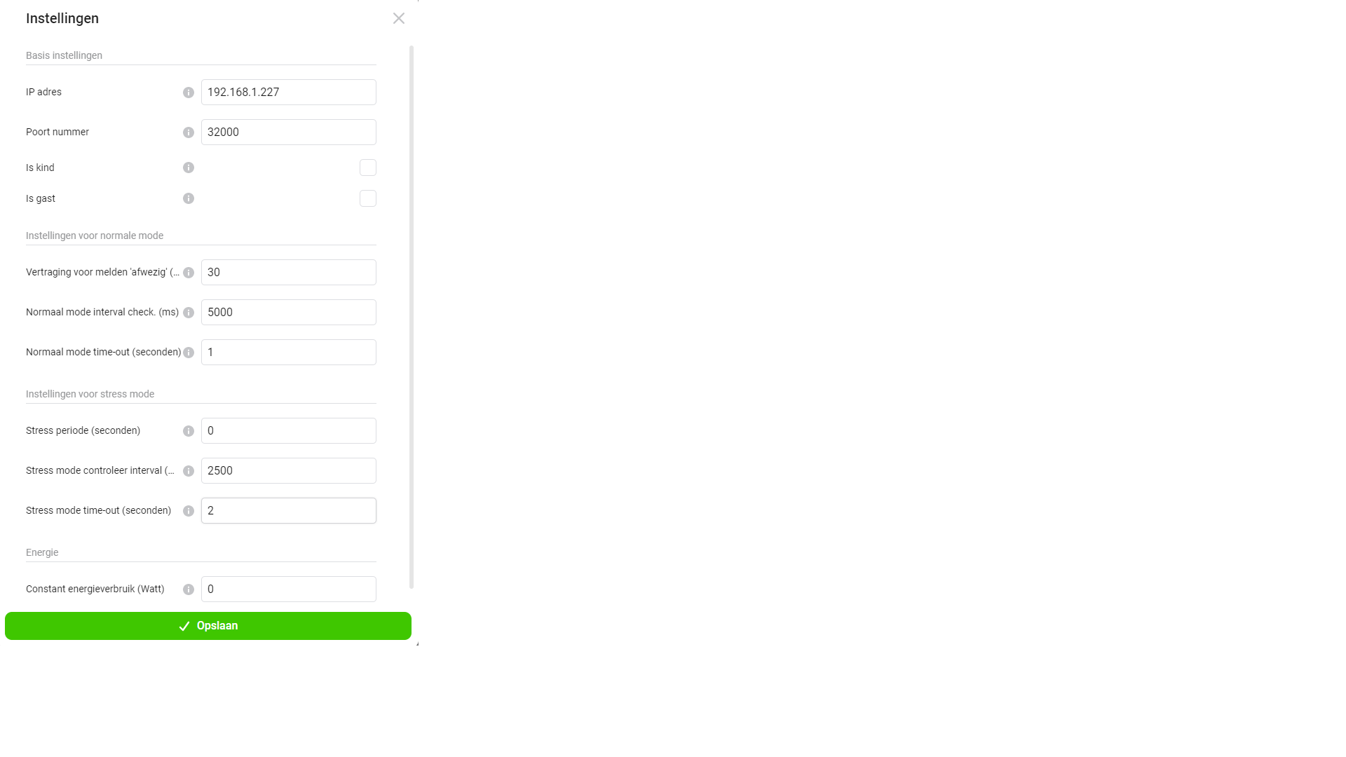

Thank you for your reply!
But waiting 25 minutes before being marked as away is rather long to be usefull in flows.
Or do the Stress period settings overrule this delay?
Do you encouter long delays in your flows using presence?
Hi. I use now a Pixel 7 Pro, since then i’m not able to recognize if it’s away anymore. I changed the IP-Adress to the IP-Adress of the mobile phone, but no succes Any Idea?

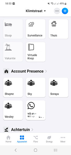

Was wondering if something has changed in the tiles? First when a members was not connected the tile was grayed out now the tile does not change in the home screen
Thanks for reporting, this seems to be indeed connected to the Homey mobile app - may I ask you, have you submitted bug report via Loading... - Form by Asana ? If not, I will do it.
