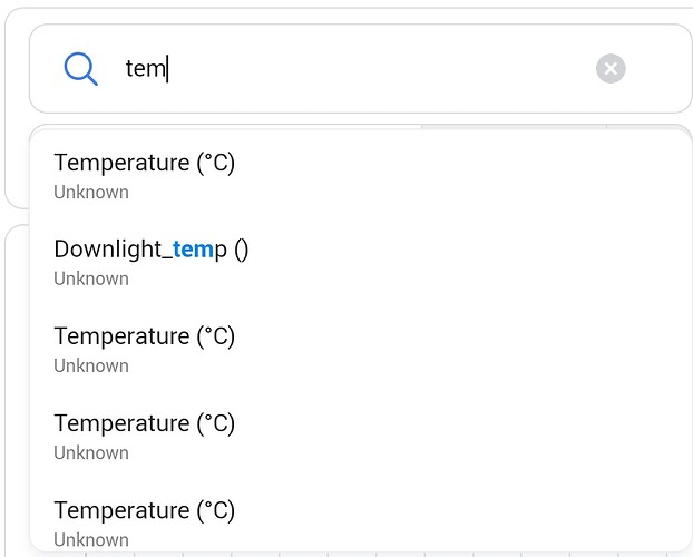

But now something is wrong with the search function. For example if I search Temperature all device names are Unknown and no curve or statistics.
I confirm
Overall however great job @spkesDE , I was never thinking you will produce even better app then MadMonkey,thank you !
Oh, i think they changed the Homey API for the HP2023.
I released a new test version so I can debug this error. Could you search for a Insight then create a diagnostic report?
Thank you! :slight_smile:
Version 1.0.12 - Still device name Unknown and no curve/statistics.
@Morgan could you create a diagnostic report for me? So I can figure out the issue?
Too quick, my Homey even can’t install new releases so quick :wink:
Tested and it’s the same - Unknown and Empty.
…tried…got error Request Entity too large ? But might be problem of my Homey maybe…
c2b49cf4-ac07-4217-bc2c-c83a2fc1633c
Yeah, what i though. API changed for Hp2023. Will fix it ASAP
And done :slight_smile: Should :crossed_fingers: hopefully fix it. @Morgan
