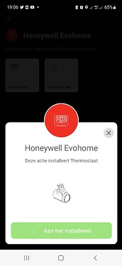

Hello Mickel,
Thanks for your quick reply.
Already read the complete toppic.
See no solution for my problem.
Alreade deinstalled app.
Try to install it again but can not get it installed.
Installing shows next picture, nothingis happening…
It’s looks according to you screenshot the pairing process is stuck even before the you need to enter the evohome TCC credentials.
This is for sure not a problem.with the '“new” evohome app…
I suggest you deinstall the evohome app,. Restart homey,. Install the evohome app and try to pair again.
